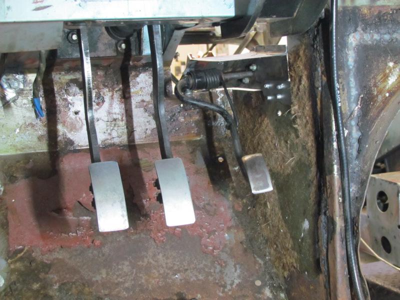

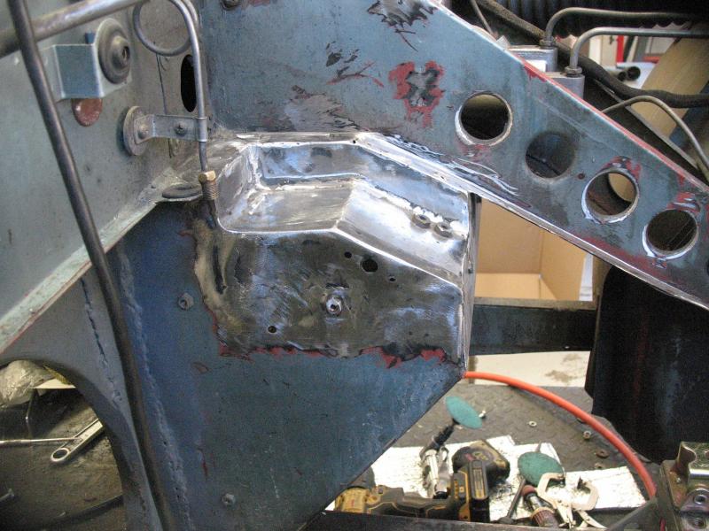

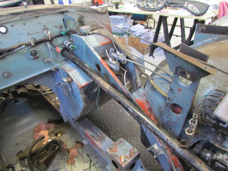

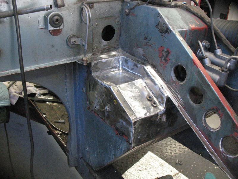

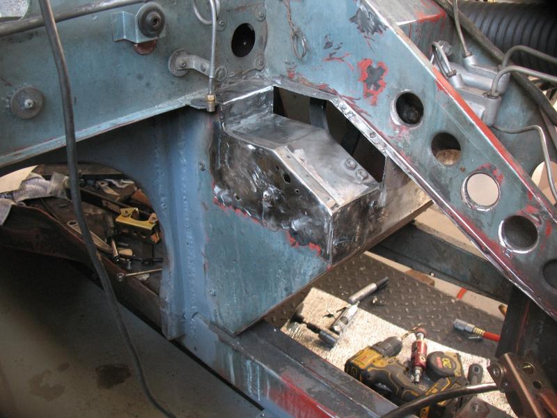

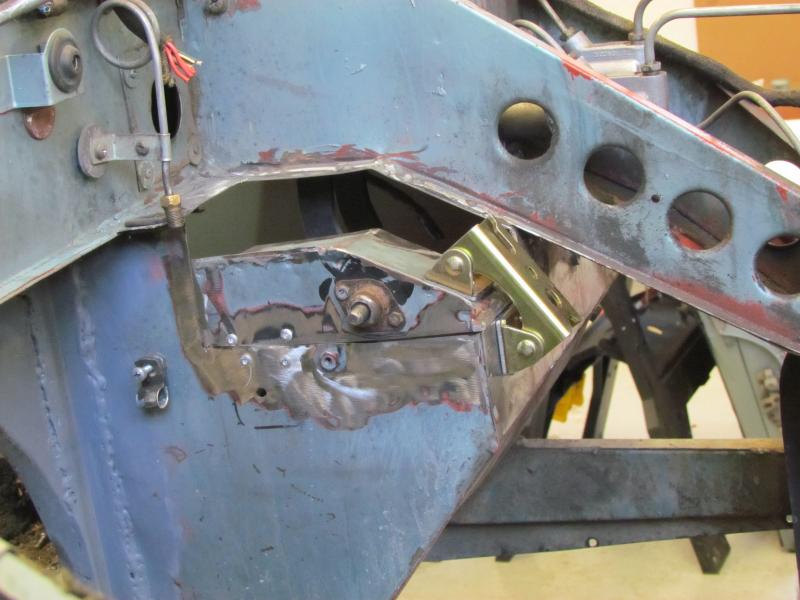

For you guys installing triple Webers that would like a bit more room... in my case for the fuel rail on my fuel injection (EFI)… I offer this. For what I'm calling the throttle box... mounting point for the accelerator... a mod that will be appreciated under the hood and will not effect the driver when it's done. I gained 1 1/2" of much needed space by lowering the top of the throttle box. You then shorten the accelerator pedal by 1 1/2" and nothing has changed for the driver. I incorporated the original fold of the stock metal to keep it looking "original." I did the same thing on my previous EFI car and some real Healey experts, even on close inspection, never spotted the change.
1 Throttle box original S50 2820.jpg 2 Throttle Box cut 1 and half inches S50 2950.jpg 3 Throttle Box test shortened lever S50 2953.jpg 4 Throttle Box mod not done S50 1065.jpg 5 Throttle Box mod S50 1073.jpg 6 Throttle box mod S50 1075.jpg
