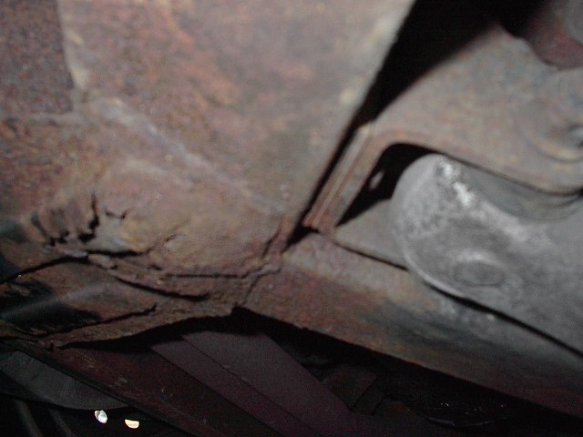

All in all it was a neat experience. My first time driving a TR6 or any British car for that matter. I printed info from the VTR link to take with me. I checked all the spots it had listed. It has on pin size rust hole in the driver side floorboard. Everything else there is solid. It has rust really bad behind the pass headlight, I have a pic but it was taken with the wrong setting so it is giant. One bad spot on one rear fender and another under the driver side door. And it had what looked to be two rust spots where the torsion bars meet the frame. Both of those were smaller than a business card or pack of matches. I think the paint was original but the owner didn't know. It had 58K on it not 69K like I thought earlier. He had warmed it up, but it drove nice. Big difference between the clutch on that and the 911. Pulled fine, ran fine, stopped and turned fine. Shifted pretty good once I got used to it. Didn't find any rust in the trunk or behind the rear seats. Could use a new dash and to get rid of the radio that is in it. All the gauges and lights seemed to work. Had some spare parts that came with it.

I would put this car up on a lift and take a closer look at the rust on this frame, with particular attention to where the trailing arms and all come together.
The rocker is obviously rusted in that rear location, and is probably also rusted under the front fender area. As long as the rust has not moved to the front and rear door posts, the rocker can be easily repaired or replaced. Rust around the head lamps is sometimes mostly limited to the lens assembly. If it has extensively moved into the fender itself, repairs can be expensive.
Body parts for these cars are available, but all require dolly and hammer work to fit properly.
If the frame is OK, and the price is right the car has possibility.

Your car's on eBay, item 330116943044
TRopic6
Good eye Kevin.
Funny how the ad doesn't have any frame shots nor mention the T-shirt frame rust that's in pookie's picture.
