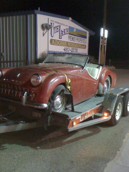

Starting my 60' TR3A on frame driver restoration and plan on doing as much of the work myself as possible. I kind of have a cost expectation of maybe $14,000 mostly on complete brake redo, fuel sys, electrical, tires, paint, interior, weather, missing hardware/parts.

They are straight forward to restore only IF the body is in good condition to start with! Take some pictures of body damage / prior repair work and post them . We would all love to see them and see just what you are starting with !

Photo looks like a good starting point. Sounds like you're in the ball park with your figures. I've done three TR3's. I don't have a lot of specialty tools so on the first one I spent a little supplementing my tool box. I also had a significant learning curve on the first one even though I had previously owned several LBC's, I had never taken on a real thorough restoration. All were done on frame due to limited space and lack of extra set of hands. The first one also came in boxes so disassembly was a snap, putting something together that I didn't take a part was a little more challenging. Time wise" I really didn't pay much attention to the time and took 3 years to get it built back, partly caused by purchasing parts as budget would allow. Don't worry too much about how long it will take, just chip away at it and enjoy the little victories. I did the body work myself and most of the mechanical but found a shop that would agree to paint over my body work...which is sometimes problematic to find as you can't expect a shop to guarantee paint over bodywork of unknown quality. Do it right the first time. I would be dollars ahead if I had just kept the first one with all its errors and gone back and corrected it instead of selling and starting over. My current car is far better than the first one. You'll find answers to any questions you have right here. It has been a very helpful reference. My current car was "almost" a rolling restoration, but I always did the "while I'm at it" task to avoid the dreaded "do overs". Have fun!!

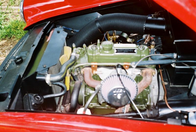

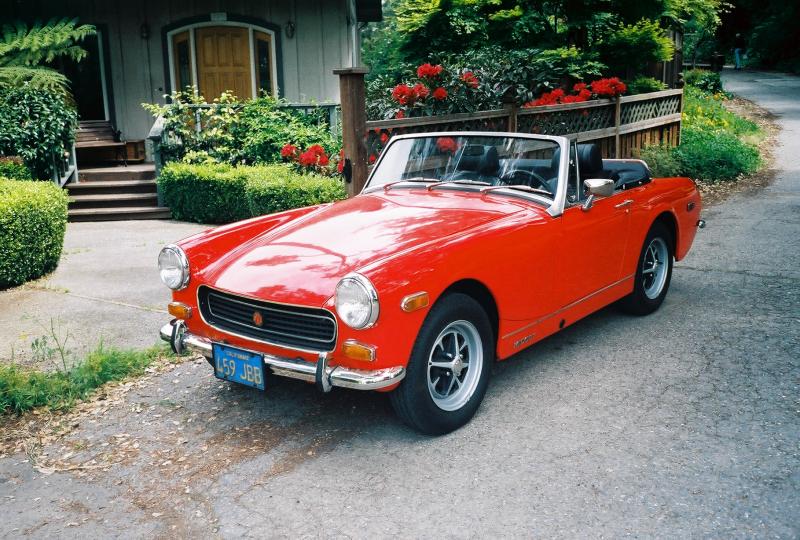

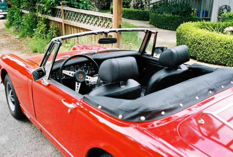

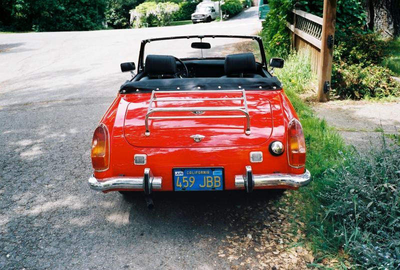

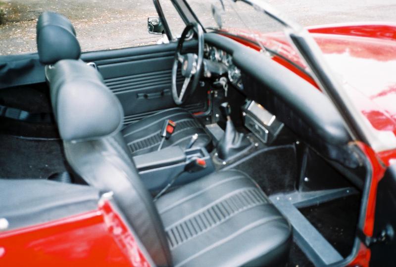

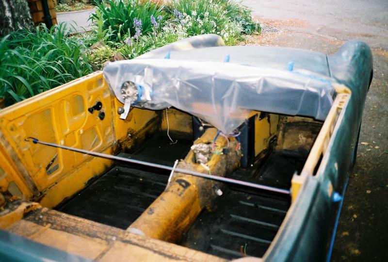

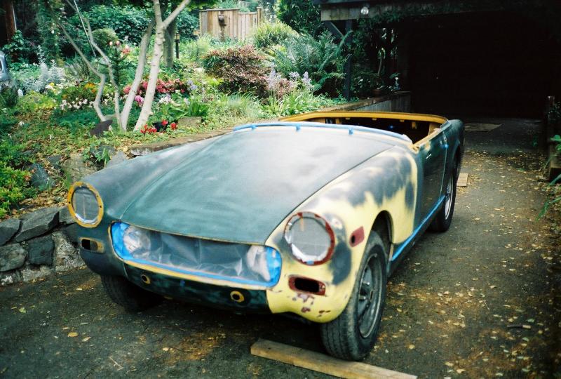

I guess I've been lucky on my British car restorations--2 Morris Minors, Austin A35 Van, 1973 MG Midget (pictured) and 3 Nash Metropolitans
Never spent more than $10,000 on each of the restorations, including the original car, and (and in some cases--parts cars)
The '73 Midget was a "driver", but very tired--no rust (no welding!)--The engine (1275) and transmission work was farmed out, and the painting
was done professionally. i did everything else myself--refurbished or new.--It was a "shell" and ready for painting when it went to the paint shop.
I took off all the smog stuff--air pump, charcoal cannister, new "early" fuel tank without the evaporative loss control, plugged the air ports in the head.
Took off the twin carbs, and fitted single HS4--with the proper exhaust--all proper upgrades--I'll post some pics later, if I can figure out how!
See previous thread on "73 Midget--posting pics (I think!)
