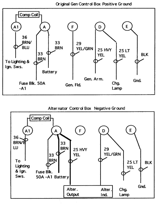

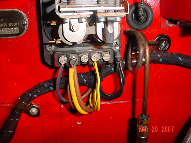

Hi Alan,
You don't actually need to "gut" the control box. If you wish to keep it original, just reconnect the external wires as shown. The box serves as tie points but does not actually get involved in the operation.
Rewiring as shown plus insulating the cut out contact with a plastic sleeve, lower right in the photo, & you are good to go. The red warning light will function as original.
D

Wrong control box Dave. There is a Tutorial with a complete wiring schematic on the web someplace for the single wire alternator upgrade. I thought I had in the file but no I didn't download it. I thought you might have it and post it.--Keoke-?

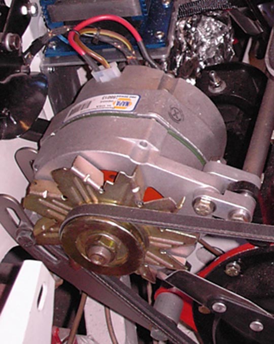

Hi R&M,
I bought the kit from Hendrix and the alternator locally. It looks like the same kit that Don Lenchow (of NTAHC) sells since the instructions on Hendrix’s sight are written by Don. I had some trouble with the NAPA part number that was supplied with the kit, but more than likely, it was the dumb kid at NAPA. The kit does come with a diagram, though I needed to call for some minor tech support. The wiring does change a little. Here is a diagram of what I did, plus a photo of the alternator I installed.

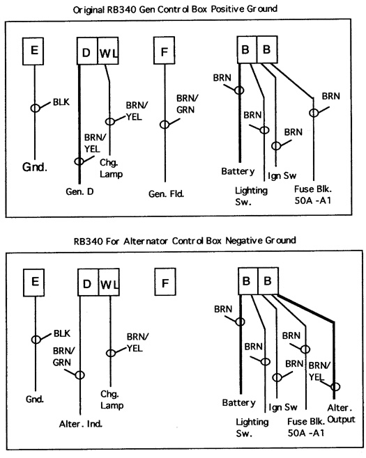

Hi Keoke,
As far as converting to an alternator, there really isn't that much difference between the earlier RB 106 control box & the later RB340. Just moving a few wires around.The attached drawing is for the RB340. The cutout contact still needs to be insulated.
D
PS - Most folks don't like the single wire alternators. No red light indicator & it takes quite a bit more rpm to get it started.

Hi Alan,
I used the Precision Parts LUA604 rebuilt by Precision Parts, Oklahoma -- https://www.pprok.com/ --from Peter at World Wide Imports. https://www.nosimport.com/
The application is 78 - 80 MGBGT. It fits my DWR alternator mount bracket perfectly.
The LUA604 is the newer version of the old Lucas 18ACR 45 amp alternator. It is compact & easy to install. It uses the same 3 in line connector. Mount clocking is the same with two mount tabs at 6 o'clock & the tension tab at 10 o'clock - front view.
I think Lucas alternators get a bad rap, usually because they are rebuilt & the rebuilder takes as many short cuts as possible. Like reusing many old parts. The quality of Precision Parts rebuilds is definitely a cut or two, or three, above the average rebuild.
I have found many rebuilt starters, generators & alternators that were apparently glass beaded for cleaning. The glass grit was not thoroughly removed from all parts, hard to do, & the resulting grit led to a short life. I started disassembling newly rebuilt starters, generators, & alternators, just to thoroughly clean the microscopic grit out of the internals. Got longer life out of the rebuilts this way. The PP alternator was microscopically clean & had all new bearings, diode pacs, & other parts.
Aside, Lucas alternators are designed to mount solidly on the front tab only. The rear tab is mounted on a semi floating sleeve so that there is no end tension on the rear mount. Saves bent or cracked mounts.
D
