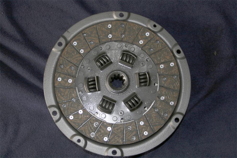

In the current configuration the clutch kit looks like the attached picture. Can anybody reason from that picture that the clutch plat is too big for the clutch cover?
In the manwhile I answered the question myself ;-) Diameter of plate is of course 9'' for a 9'' clutch cover. The configuration that has been delivered by the company which refurbished my clutch is a 9'' cover with a 9,5'' plate :-(

Based on the photo above although it is for a 10" pack (BN7) , the clutch plate has a lot more space to the clutch cover bolt holes than yours is showing. So you found your problem -- too big of a clutch disk for the clutch cover.
