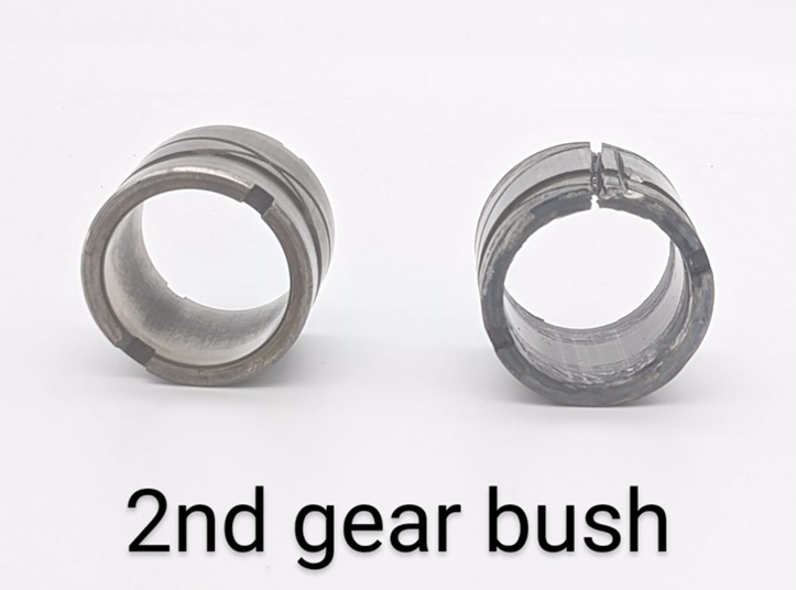

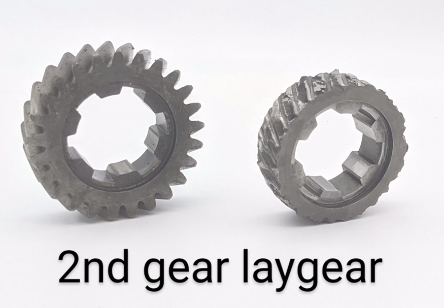

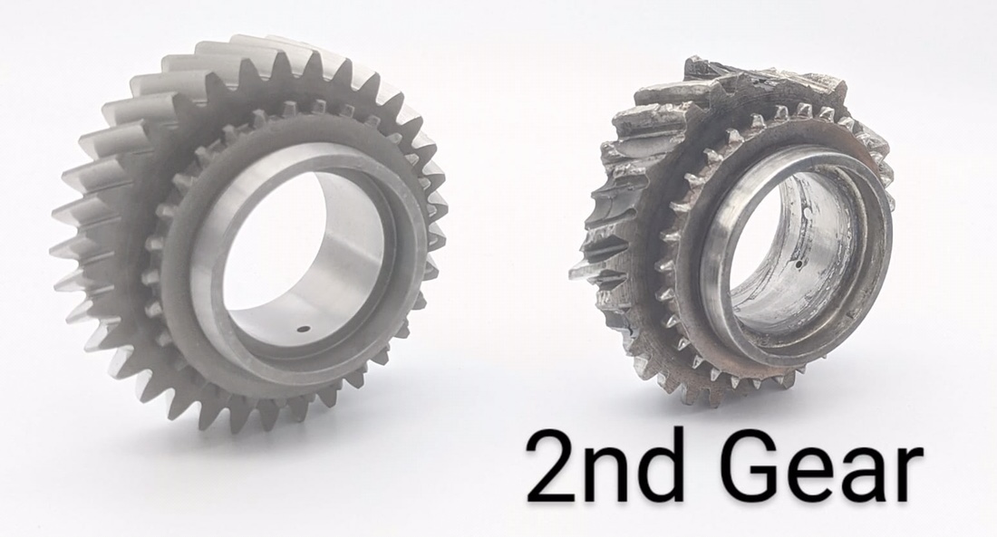

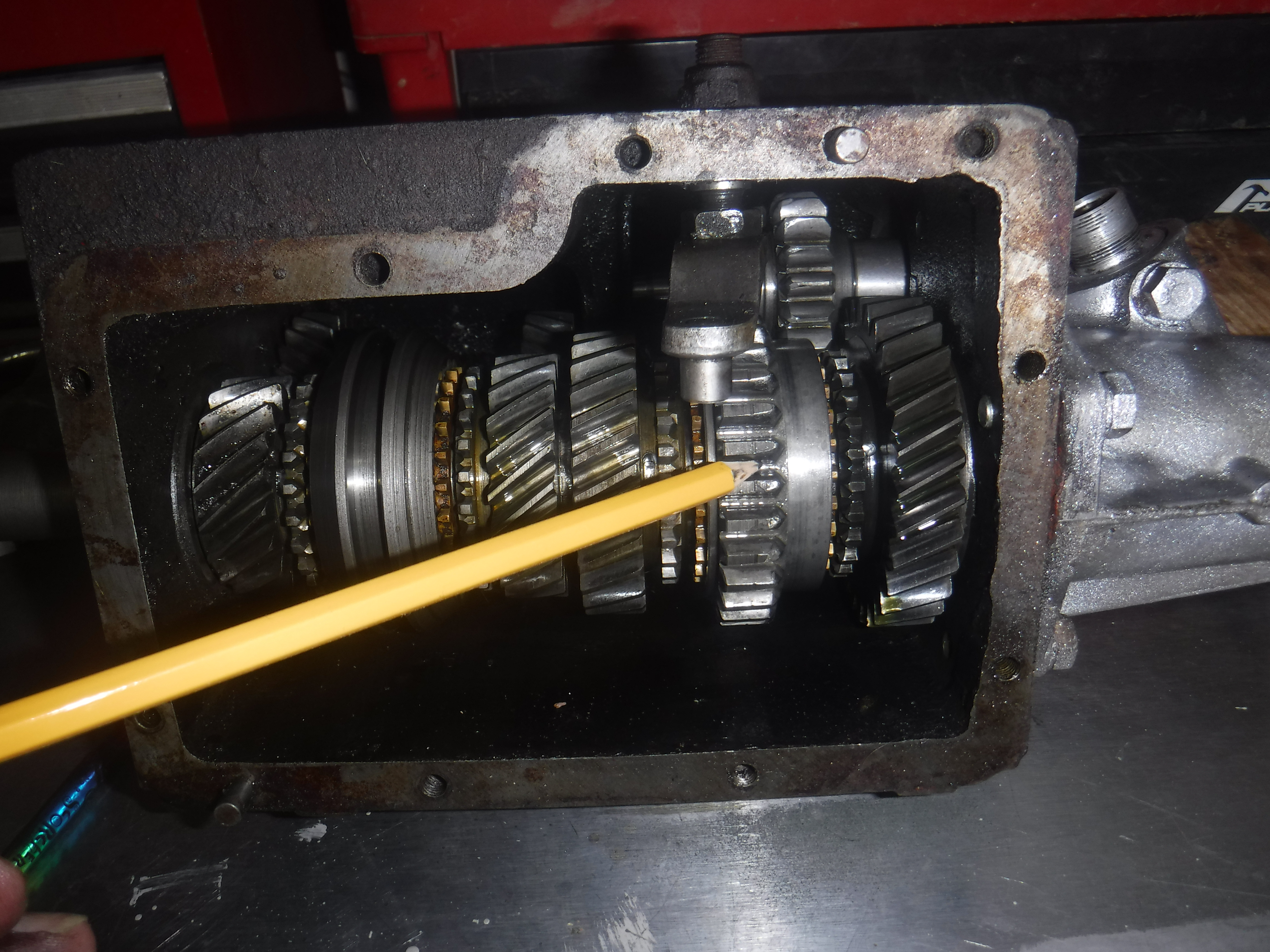

has been true to his word and opened the box and started to strip it and sent me some annotated pics
this is the first
look closely and you may just see - with a trained eye and experience - the minor defect.
Answers on a post card as they used to say. !!!
Better see a dentist, you’ve got chipped teeth! Lots of ‘em!
That was easier than “Where’s Waldo?”
These are some more pics with what they should look like.

Oh my word! You know, if you'd just quit racing the thing...

Interesting that it happened in 4th, as 4th does not load any of the gear teeth. It's just a straight through coupling to the mainshaft. I suspect a tooth was lost earlier, and it was just waiting to get caught in the other gears. Did you notice a regular clicking noise before the bang?

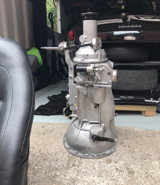

Well the gearbox specialist have worked wonders and after a 1.5hr trip there and a 2.5hr trip back I have a refurbished and somewhat uprated gearbox to wrestle into the car tomorrow. Many of you know taking it out is the easy bit.
refitting takes a lot of precision lining up for it all to slide together nicely
Tomorrow will tell

Hi @poolboy not quite that good/different.
I think is mainly a new thicker 2nd gear thrust washer with 2nd gear n machined to make room for it.

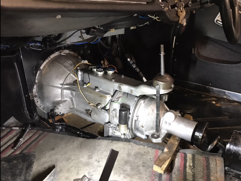

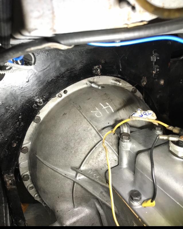

Mate came round this morning to help refit the box. We were planning for a battle and bad words but 10 mins and it was fitted and bolts fitted great result and the best refit to date (and I’ve done it a few times)
A few long stud at the top helps a lot and a mate fo that extra help. As it’s a heavy lump with the od !
all ancillaries fitted and interior in at my leisure the rest of the day.
run up on axles stands and all seems to work well.
