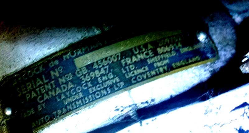

What would be the best way to verify the OD ratio? Thanks.
There's a brass plate conveniently located on the top of the OD - the first number is the percentage. You can just make out the 28 on mine. Apologies for the lame pic:
