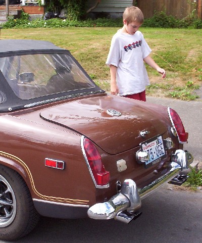

Gave Frankie a little facelift this weekend
RickB said:
Yes Bill - I've seen that one before!
So that's an active scoop?
What's it feeding into?
Yes, it's active.
I installed an HIF6, which has the fuel bowl at the bottom. This makes them somewhat sensitive to heat. Also, I chose to use a manifold intended for a Mini, rather than the Spridget version which angles downward. (There's a <span style="font-style: italic">slight</span> performance advantage using the Mini version) That creates a clearance issue.
So, the scoop allows for clearance, and is centered so that air is directed downwards to cool the HIF and provide a bit to the air filter as well.
It's difficult to see, but here's a photo:
I like your bumper transplant; car's looking good!
