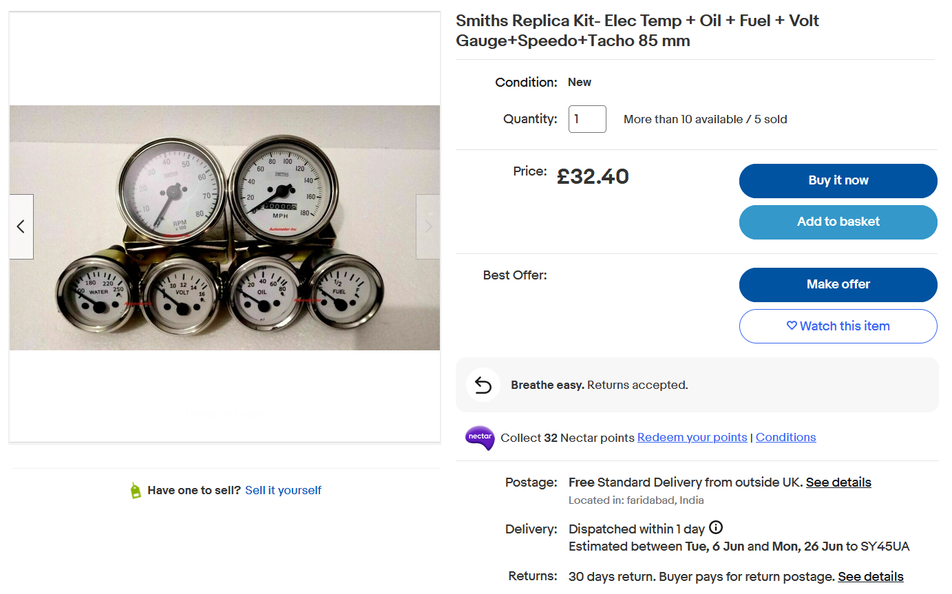

These are available on ebay, made in india, they are prety good reproduction o smths gauges. can put your own led bulbs in them.

There are these available from the UK. You might find them here in the US. I’ve never seen them first hand but they’ve been discussed before and IIRC owners have been happy with them…
I found the Smiths Replica Kits on Ebay and Amazon. I am concerned what the quality will be like in a 6 gauge set that costs less than $45. The one reviewer I found said, they are out of calibration and the speedo makes too much noise. By stark contrast, Mo-Ma quoted me 62 times more money ($2,800) to restore mine in either black or white. Both are outliers of what I want to pay for a set of gauges. So, I am still shopping for a solution. I might try to open and clean my existing gauges. Still shopping before deciding.

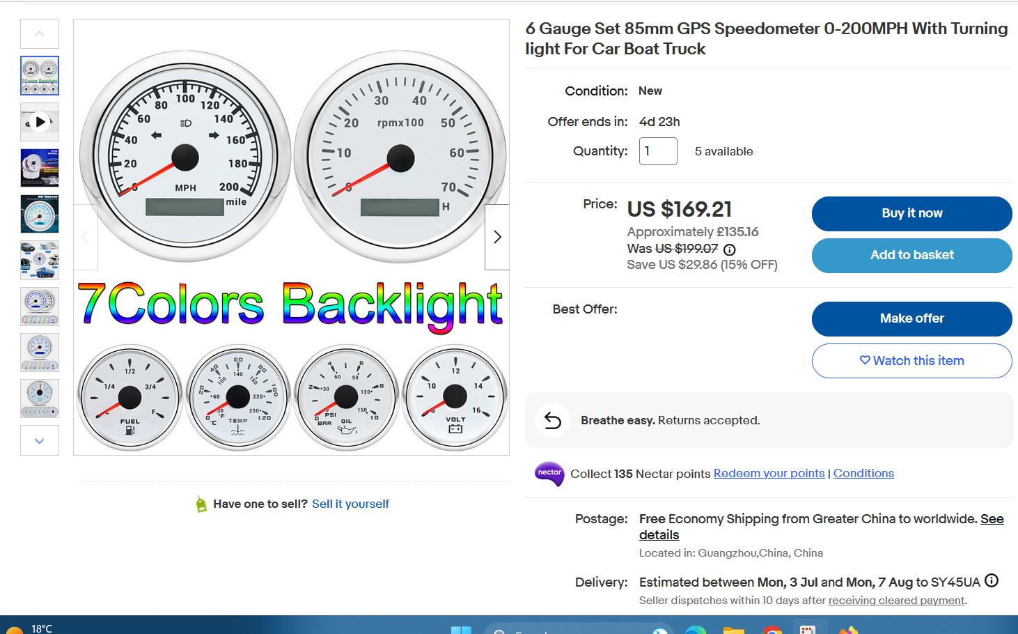

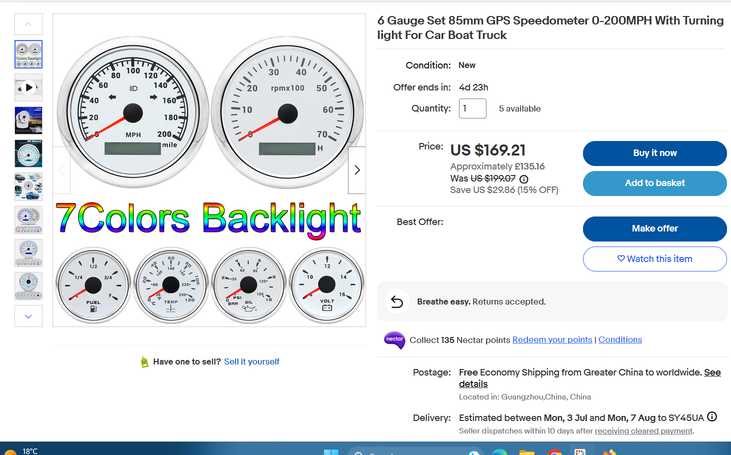

This is another option, and one i will be considering using on my panther when the time comes.
All electronic, speedo is GPS rev counter runs off the alternator, seven colour led, so you can set the colour to match your mood, Some sets are offered with the senders also included.
You got me thinking, Mezy. I don't know if my TR3A has an alternator or a starter/generator. I will check when I get back home next week. (my work schedule is one week on and one week off). The set shown here has a voltmeter, which would be better suited to an alternator than my existing ammeter.

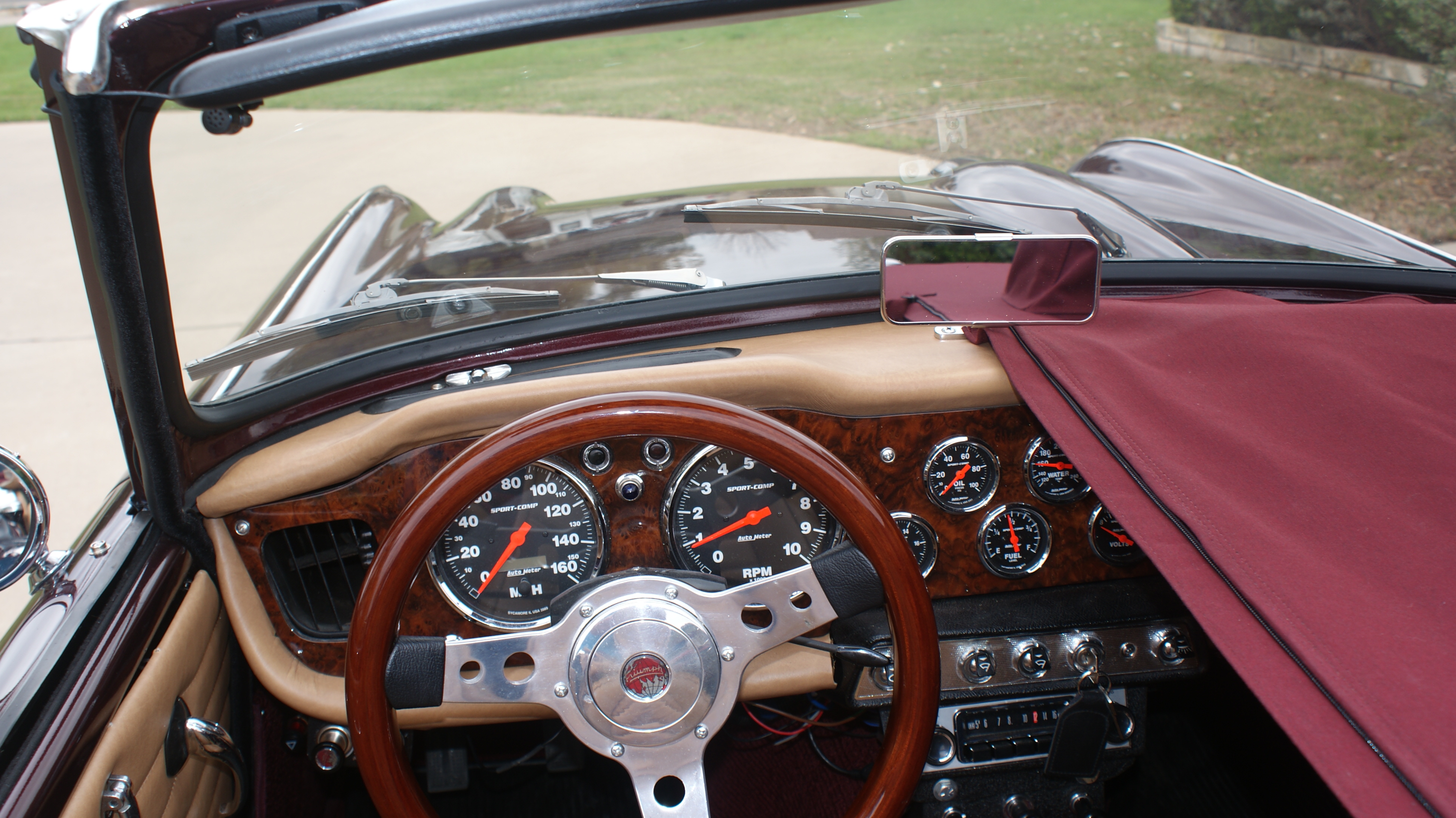

I used Autometer Gauges Sport Comp I & II gauges in my TR4. I pried off the plastic bezels and installed Smiths/Jaeger Bezels to make them look period correct. The Tach and the Speedo need a signal from somewhere, I used a GPS module for the speedo and pulled a signal from the coil(s) for the tach.

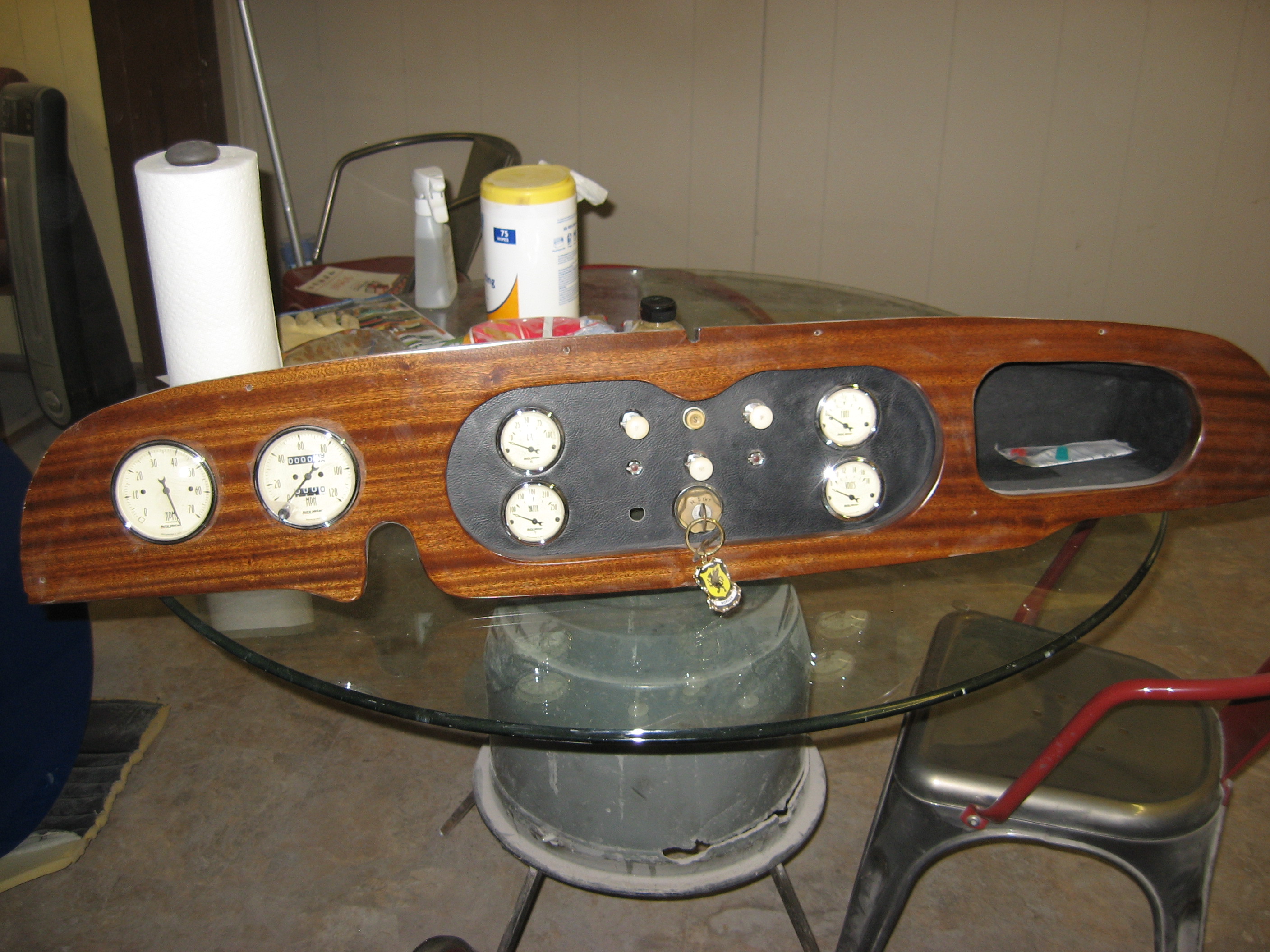

This is a street rod thing the have the antique white with a vintage ,bought from Speedway(autometer?)
