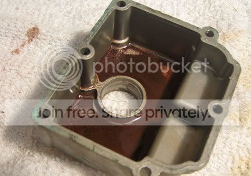

<span style="color: #990000">A decent concept except my filters do not get
clogged up. It is the powdered rust that goes right thru
the filters and ends up as rust "mud" in my carb bowls
that is causing all the problems.
Two car breakdowns directly attributed to this tank originated
rust "mud" jamming up the carbs.
d</span>

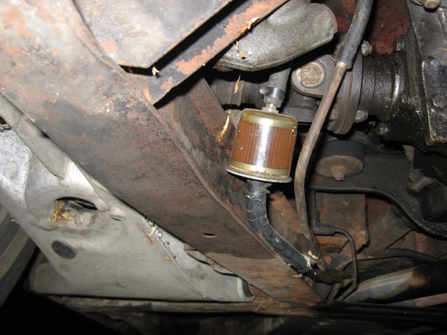

I had the exact same problem with "rust mud". The POR dealer was 200 miles away on the Big Island but they were able to direct me to the agent on my island. He had the goods in his garage and I finally got the tank coated. The rust was coming from the 'roof' of the tank where the fuel dosen't cover. Maybe ethanol gas holding water made it prone to rust.
Anyway, while I orchestrated all that, I fitted a Fram G12 filter at the exit of the tank. Gravity caused most of the rust mud to settle and collect at the lower end of the filter. I changed the filter after coating the tank - you can see some white stuff is settled in there now (maybe it's sand).
The long rear-to-front run of pipe was full of the mud, which I used a copper wire then a Camelback 'snake' to clean out. The carb bowl fuel valve had a screen covering the inlet side, which was half plugged with the stuff too. All this caused weird problems until I got it all sorted out.

74 & 75.5 TR6
Now THAT's a decent temporary fix!
Magnets plus filters should keep the car streetable
