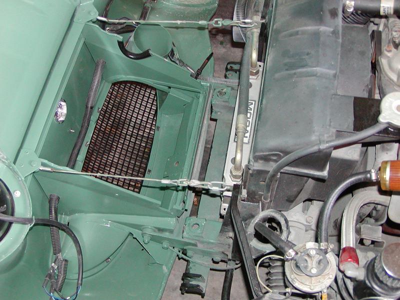

My brother mounted the fuel pump up front when the motor was first changed to a 1098. Thought it would work fine as the 948 mechanical was just below it on the block. It still resides in the same spot 43-45 years later. Easy to get to for sure......
If you can get that kind of life out of a SU pump then you must be doing thing's right!!:encouragement:
