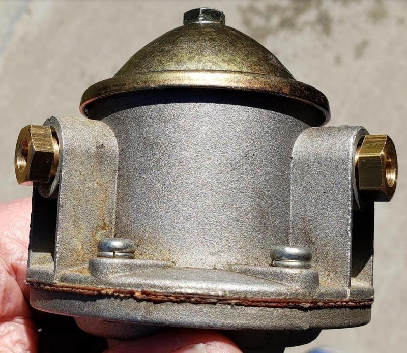

I have a couple of the 1/4" tube nuts bought from Moss - checked them on my old fuel pump. They are 1/2-20 threads and also fit the 5/16" input which has the same threads.
An American tube nut with 1/2-20 threads would screw in, but would it be long enough to seat? Not sure what the socket is like on the bottom of the tank. Maybe one would have to double up on the compression rings.
Anyway, seems like it would be easier to just buy the nuts from Moss for $4.
