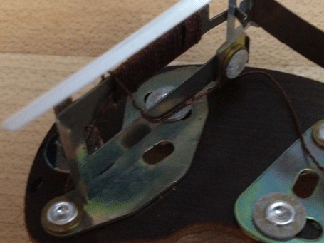

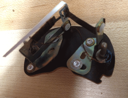

You guys here all taught me to be too finicky. So, I've already pulled my gauge apart to see inside. I see some awfully weak and frayed wires. It would take some real skill to solder them back.
Please take a look, and share your thoughts please. You can see the little frayed wires:

Hmm, I've never been very good at this part, but let's try a quick lesson in electricity:
Voltage is a potential, it doesn't really "flow". The usual comparison is water pressure. Imagine for a moment, a dam with water behind it, and a closed valve at the bottom. The pressure at the valve is kind of like voltage, it is just a potential for flow.
Current is kind of like the water flowing somewhere. So if you open the valve, you get some water flow. How much flow depends on how high the water is behind the dam (the voltage), plus how far you open the valve (which is comparable to resistance). If you measure the pressure before the valve, it will remain nearly the same, regardless of how much water is flowing. If you measure after the valve, you'll get nearly zero, again regardless of how much water is flowing.
After that, the comparison kind of breaks down, so we'll let it go at that. The important bit is that current and voltage measure different aspects of electricity.
The voltage stabilizer doesn't stabilize the voltage, what it stabilizes is the gauge reading. Since the gauge mechanism responds relatively slowly, the VS can work by switching between full battery voltage, and zero volts. (You didn't measure zero because your voltmeter doesn't respond quickly enough.) The VS is needed because the battery voltage is not a constant 12.0 volts but can rise to as much as 15 volts under some circumstances (like driving down the road on a cold day) and possibly drop below 12 volts (idling for a long time with the head lights, heater, and brake lights on).
Inside, it has a coil of resistance wire, effectively an electric heater, wrapped around a bimetallic strip. The bimetallic strip consists of two different kinds of metal bonded together, with different rates of expansion with temperature. So when it gets hot, one side expands more than the other, and forces the strip into a curve. The end of the strip in the VS has a contact that closes when the strip cools, and applies ignition voltage to the heater (and to the gauges). The heater heats the strip up, the contacts open and the cycle repeats.
This sounds very complicated and Rube Goldberg, but for 1960 technology it is actually very simple, rugged, and most importantly, cheap. There are a surprising number of original voltage stabilizers that still work today! (Quite a contrast to my 1970 Audi, which used a crude electronic regulator that seemed to fail every 3 or 4 years.)
Inside the gauge is another heater and bimetal strip (on the left in your photos above). But this time, the end of the bimetal strip is connected to the indicator needle, through a linkage that magnifies the movement of the strip. How hot the heater gets depends on how much power it dissipates.
Since one side is supplied with (essentially) a constant 10 volts, the resistance of the sender is what controls the current through the gauge (and the voltage across it). Power is voltage times current, so the heater temperature (and hence needle position) depends on the resistance of the sending unit.
Clear as mud? There will be a quiz on Friday!

What I'm not sure about is the .062 measurement you reported. Very few ohmmeters read as low as .001 ohms (the leads have much more resistance than that), so I'm guessing that it was actually .062 Kiloohms (62 ohms) or .062 Megohms (62,000 ohms). 62 ohms would be fairly close I think, while 62,000 is much too high.
But either way, you saw a definite voltage drop across the gauge with (I assume) the gauge reading empty. So something is wrong with it.
Right again. It's 62 ohms, meaning my resistance is probably OK and those slightly frayed wires I might just "let well enough alone."?
Fiddling with copper wires the thickness of shirt threads wouldn't be easy, and I can't imagine what I might ruin something with a soldering iron. I'm seeing an electrical shop today to see what they have.

Finally: If the sender is bad wouldn't I see at least some heating of that bi-metallic arm in the gauge, and at least some reading?

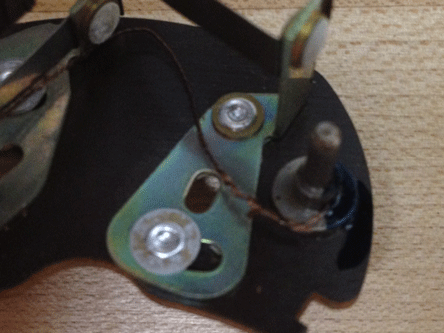

Another pic for kicks:

Quick test, jumper the sender wire to ground at the sender. If the gauge now climbs towards full, the sender is the problem.

If I jump direct to the green/black at the sender, meaning from the green black to ground, then my gauge works!!!
Those gauge wires still look frayed so what if I dab some conductive epoxy on them--no good or a good precaution?
And the question: does this mean its the sender that's bad? I guess so Randall. Thanks for the help!!!
If you just filled the tank (rather than manually pulling up the lever), then it might be a bad float. Or it might just be a broken wire inside the sender. Either way, you're going to have to pull it out.
I'd leave the wires alone, personally. They have to flex to some extent as the gauge moves, and I suspect be more likely to break right at the edge of the epoxy.
