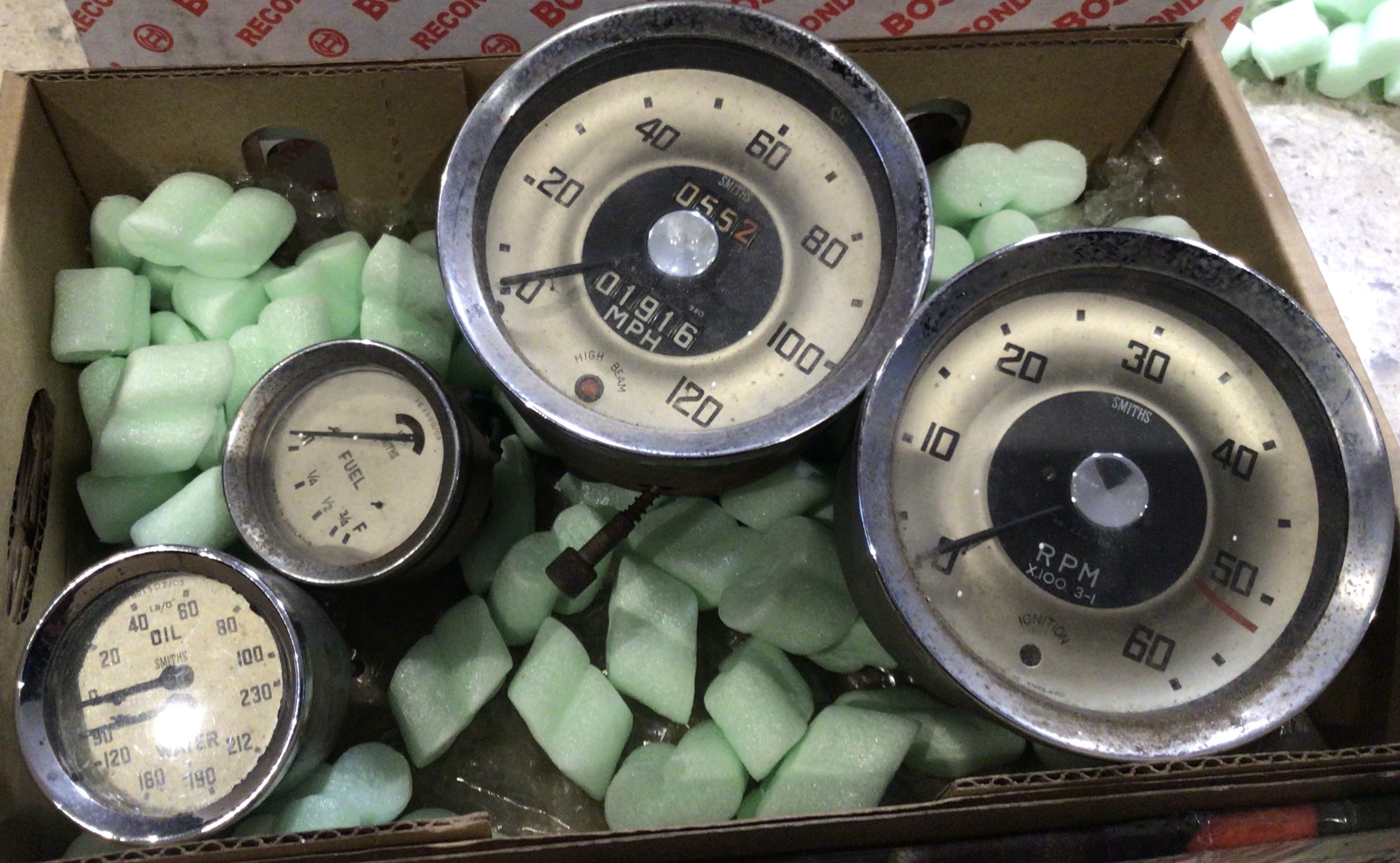

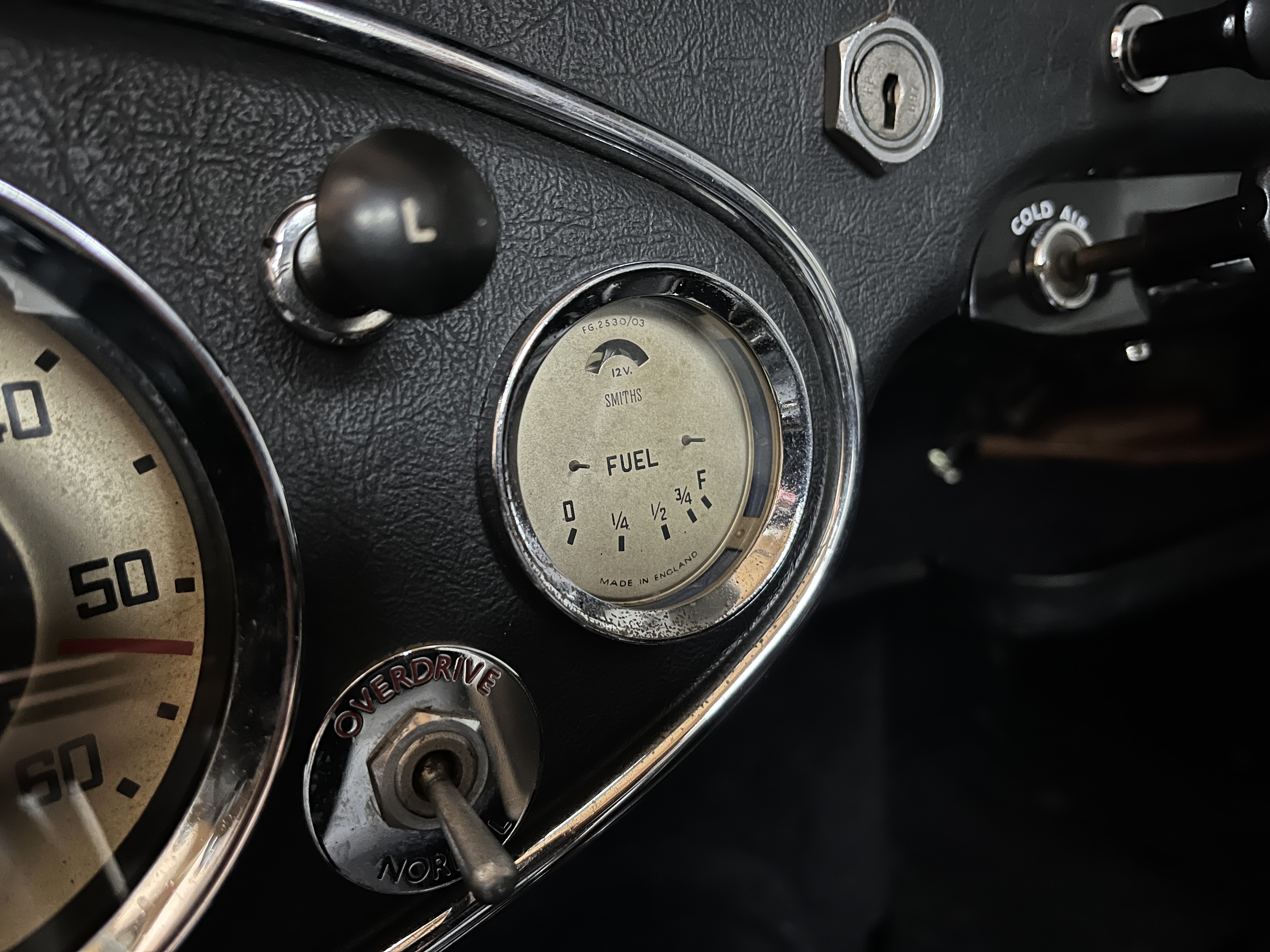

Before and after of my instruments for my BT7 . All done by West Valley .
And the bits you can’t see are just as well done

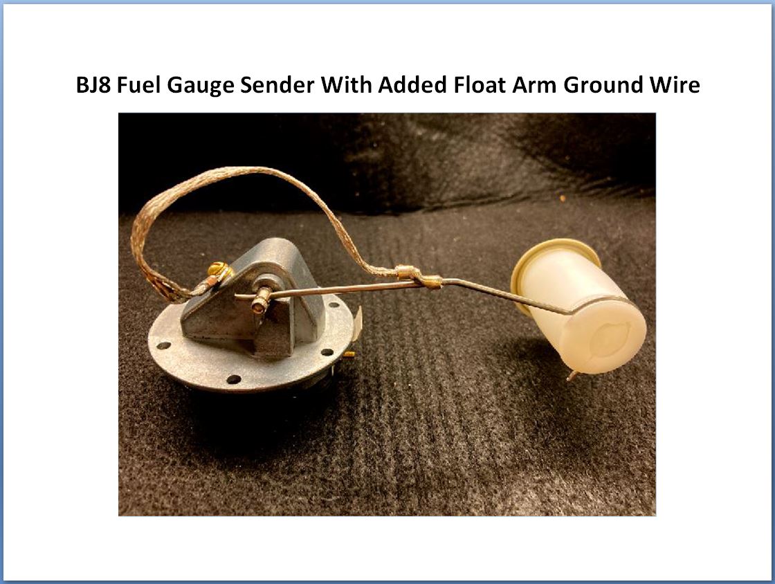

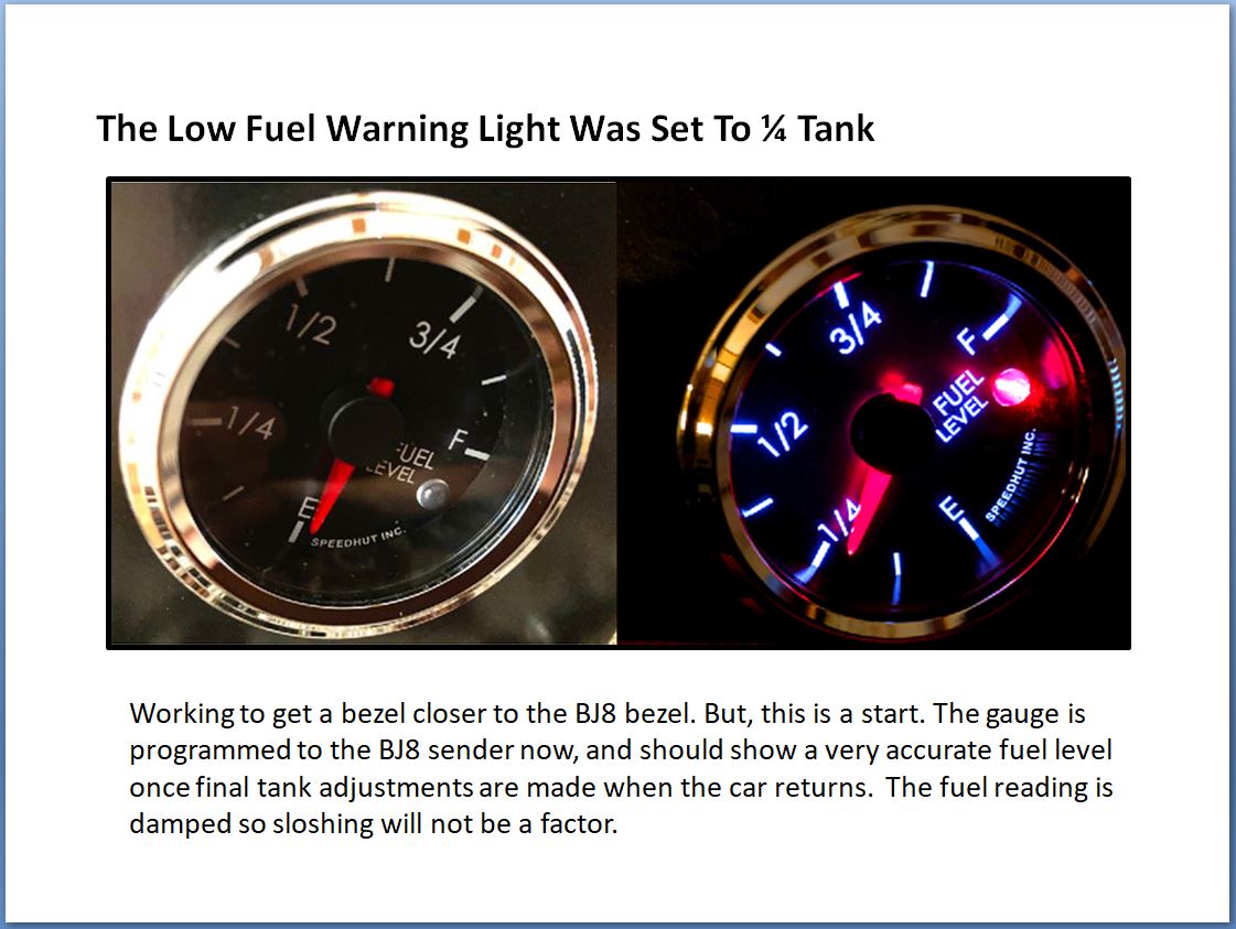

This is just an idea, but if you drive you car, you might consider restoring you original fuel gauge and saving it for the future.
A modern programmable fuel gauge works much better with data averaging (more stable needle) and you can set lights to come on when you tank is at 25% (or any amount you want). There are a number of bezel options that are close to the old Smith gauges. Unlike the original, modern fuel gauges are more accurate and more dependable. And, they are easily calibrated to ANY fuel sender.

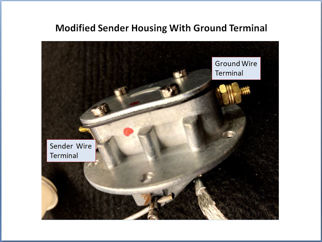

Also, its a good time to make sure your sender is well grounded. Most fuel gauge problems are due to poor grounding.
