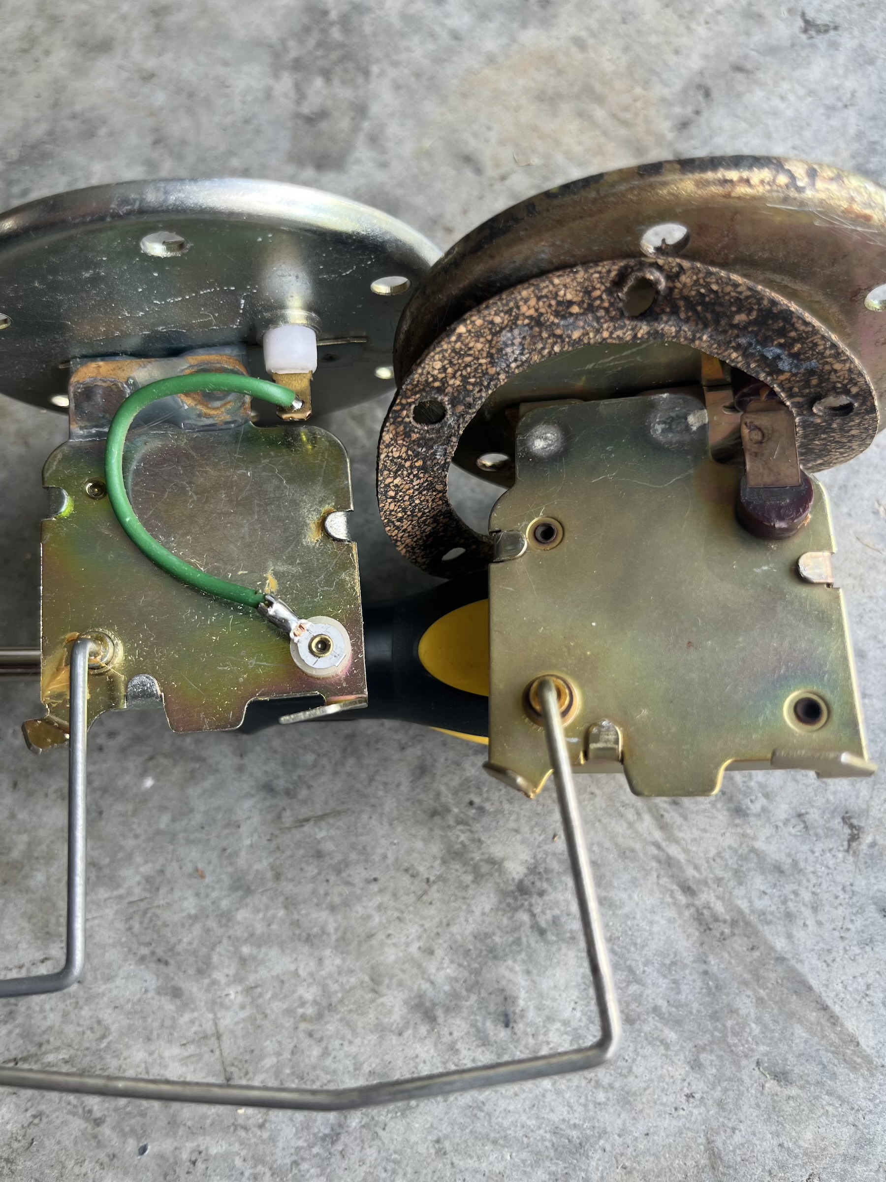

Took my TR6 out on Sunday for the first drive of the season. Fuel gauge showed about a 1/2 tank. When I looked at the gauge a few mins later, it showed 1/8 tank. To be sure I didn't run out of fuel, I added 4 gallons to the tank. The fuel gauge did not move off the 1/8 mark.
OK, here's what I did to diagnose the problem:
I'm getting ready to order a new sending unit but before I place my order, is there something I missed? Do you agree with the diagnosis that it could only be the sender?
- Grounded the fuel sender and the needle on the fuel gauge moved to Full. This tells me that the gauge is working
- Measured the voltage at the sender and the temperature sensor. Both showed 10v. This tells me the solid state voltage regulator is also working.
