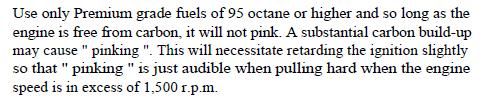

Obvously, my previous comments were basic and for general use. No doubt that heat can change things. People often mistake 95 octane in the original specs for modern octane ratings, which it is closer to 89 and change. You are indeed absolutely correct that some rebuild and modified TR engines run better on 91+, and my own previous TR3 was less prone to pinging in the Summer on wide-open-throttle on 91 octane, but it had been skimmed and was running a little more advance. My first TR3, which I ran in Houston Summers was fine on 87.
