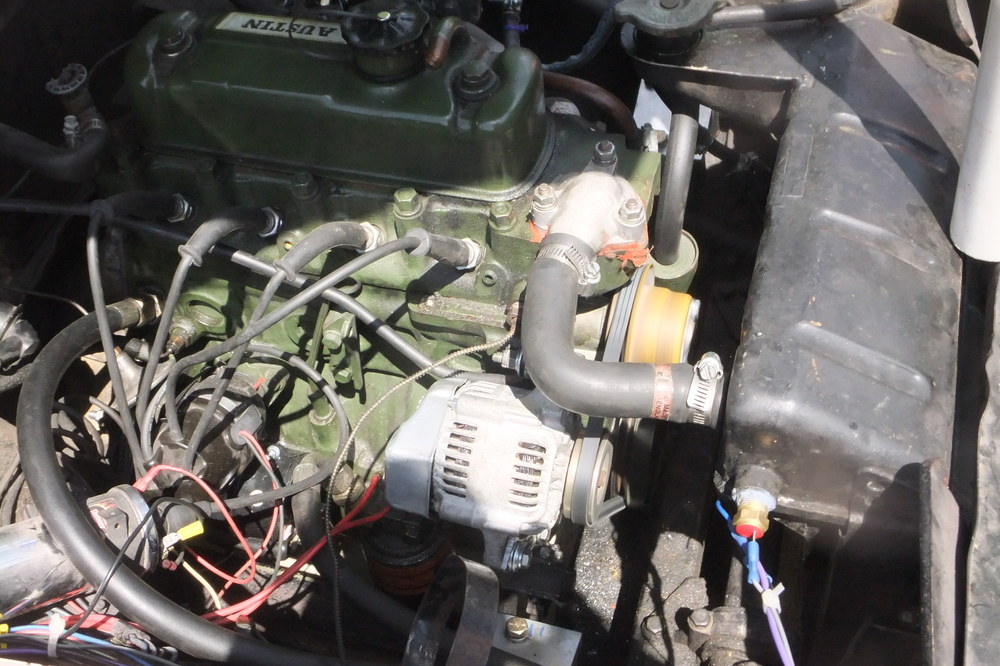

Some of the other unique upgrades I did was an alternator. With the suspension upgrade, I could have gotten the Delphi alt back in but some serious engineering would have had to been done with the bracket. I was able to go to an alt shop (specializes in rebuilding) and get "the smallest one they've heard of". A Kubota Tractor alt kicking out 70 amps. I'll attach a pic. It's small & mightly and looks great. No crazy bracket here. Bracket to engine mount and presto ! Price ~ $120 incl bracket + new belt.
