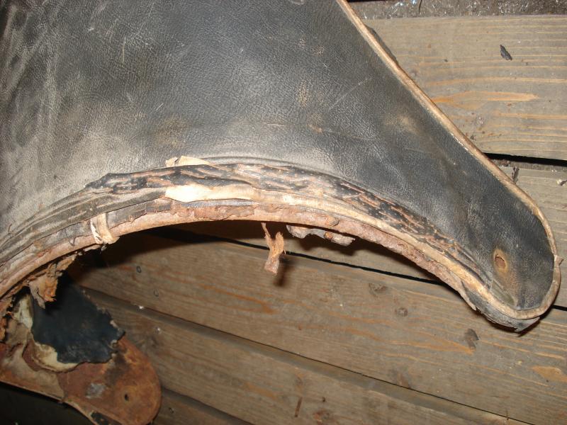

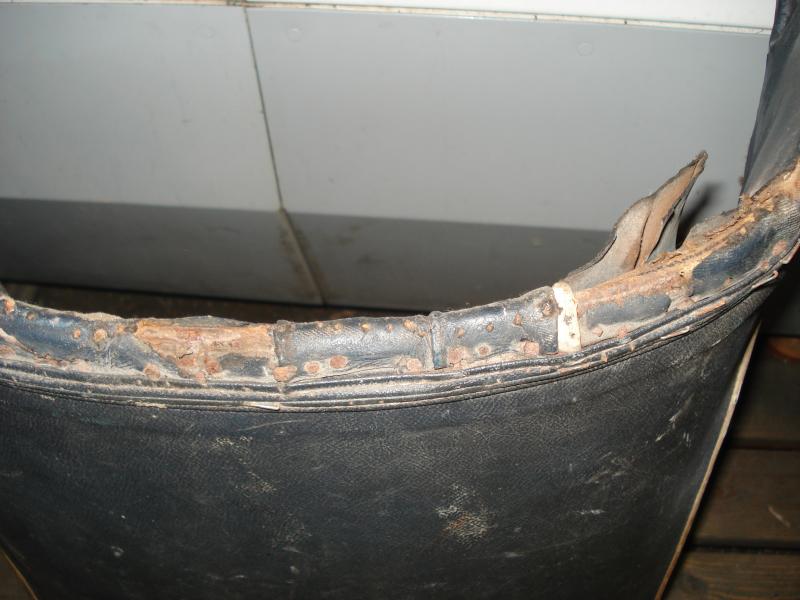

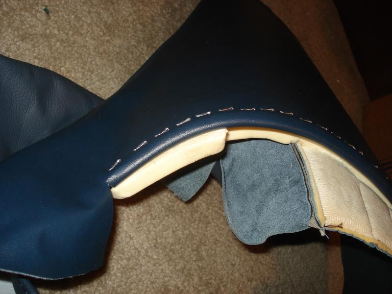

I just received a new front seat kit from Moss for my EARLY 100-6 (which is the same seat kit as the 100’s).
Does anyone have any photos showing the stretching and tacking the bottom of the seatback to the wooden strips.

healeyblue

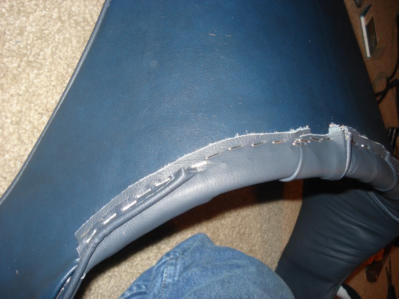

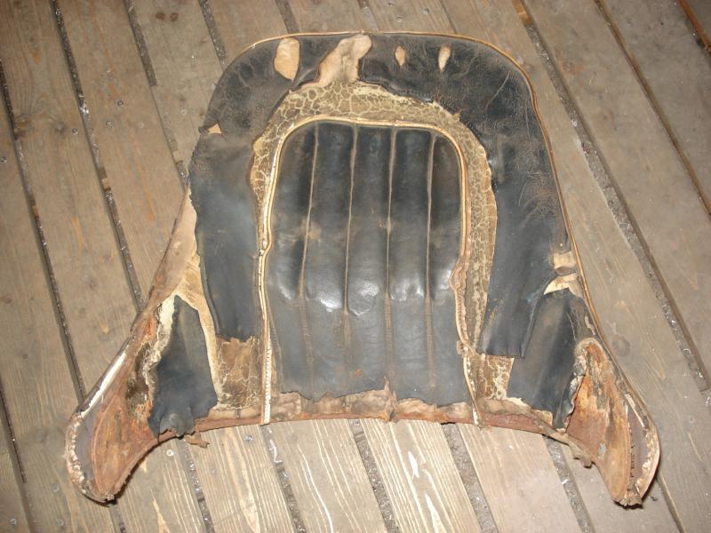

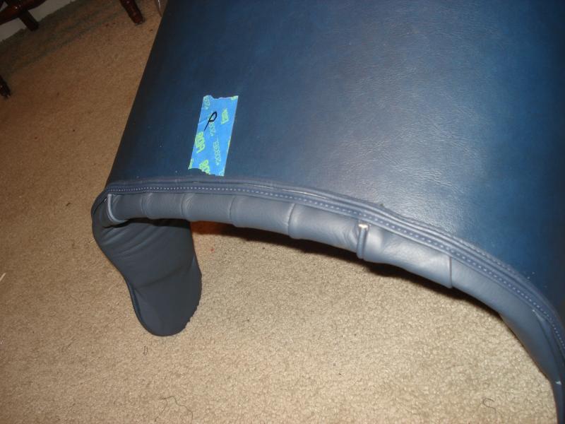

healeyblue
I think the 'hidem' strip should run along the bottom of the seat. You should not be able to see the leather panels on the back side.
I just redid how I found the original. I'm not sure what is factory correct, just how I found it
