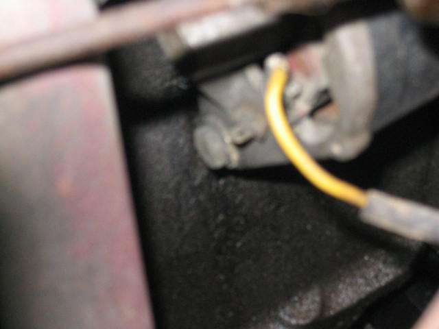

Still haven't connected up the yellow green to the generator. This is my first foray into auto mechanics, and I'm scared to death I'm going to fry something. Have tried to get a picture of this, hope it comes through below. I think the yellow green goes on the spade connection just to the left and under the yellow connection a bit, correct?

Re-read earlier post I made yes the Y/G go's to that post you are referring too but you should trace with continuity tester back to control box. (see earlier post) I'm not aware of wires just breaking in the harness but someone somewhere has probably had that happen. Usually wire problems are caused by PO's who take something apart and leave off long enough to forget where they all go back without marking or making notes. Did you get the wiring schematic? You need to study the diagram and check all your wiring before you put current to anything with a continuity tester.
Sorry, Harry, I did mean to put in the last post that I had checked that the yellow wire went to the D post on the control box, and the yellow green to the F as you cautioned and as per the wiring diagram (which I did have). That's when I noticed that single blue wire coming out of nowhere and attaching itself to the solenoid and I thought, "whoa, blue is supposed to be headlights, right?" I'm not much of a mechanic, at least not yet, but I sure didn't think that was right until I traced it and saw what had been done.
