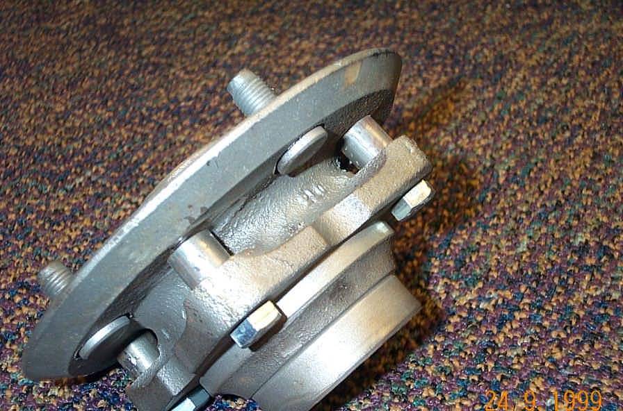

Another option is to reinforce the original type hubs. Here's a photo courtesy Jack Brooks.
Thanks Randall. I had not heard of reinforcing the stock hubs. Any more info on that available?
Basically they drill a hole in the hub face, directly in line with the bolts that hold the brake disc to the hub. Then run a long tap through the existing threads and tap the new holes. The spacer is cut to length so it is tight in the space available (has to be rapped with a hammer to install), then a long bolt is run through the brake disc, spacer and into the hub face. I believe there is a more complete write-up in one of Kas Kastner's books (but don't recall which one offhand). (BTW, Kas says this mod works well.)
