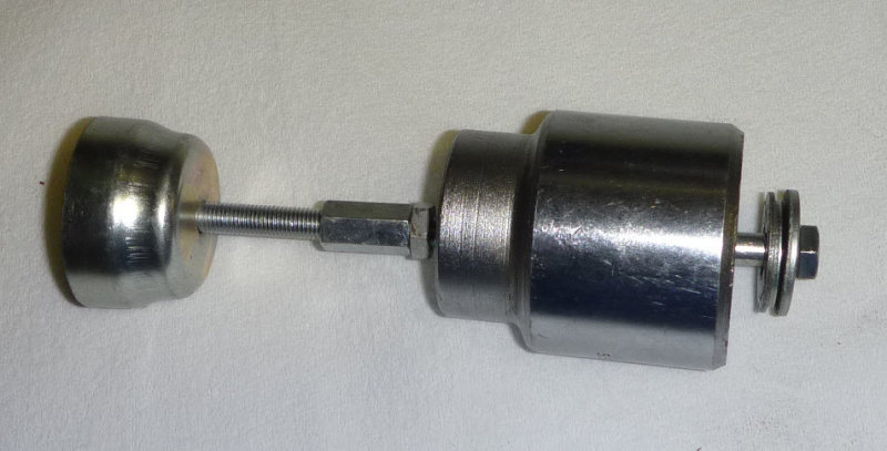

I made this tool from a 5/16" bolt, nut and coupling. Added the large socket as a slide hammer:
Installer version - small socket and large washer keep dust cover stud from installing at an angle:
