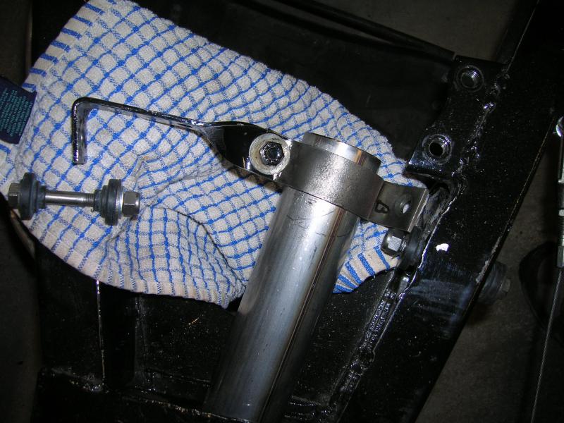

charleyf
Gary,
The two bolts are 2-1/2" plus the 1" clamping bolt all 5/16" diameter, 4 to 6 flat washers and of course the four grommets and three nuts. Note that these grommets are flat on one side and stepped on the other side. That is so they fit into the holes in the side of the frame.
