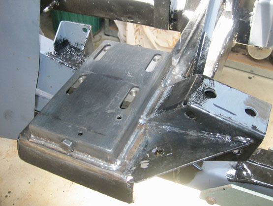

Sorry to come in late, but thought may be of interest. I went with the Kilmartin camber kit which repaired a stripped thread and hopefully has other advantages. Photo attached

Another nice thing about this adjustable Kilmartin plate are the holes appear to be machine drilled and tapped.
One thing I don't like about the original plates is with the wonky weld nuts, they rarely line up properly and it can be a bee-yoch to get the bolts in on a shock absorber when replacing, it seems like half the time I am cross threading the bolts.
This plate should stop this problem...

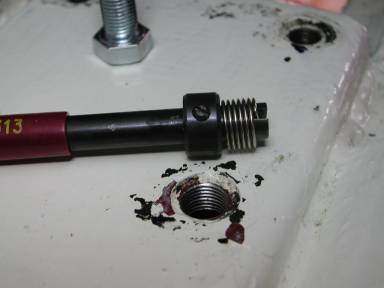

Thats the new thread waiting to have the insert screwed home. Here is the special tool ready to go.

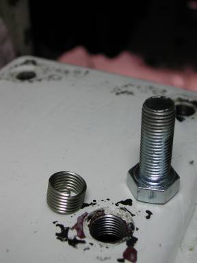

And the insert in place. To be perfect I should have wound it in another half a turn.

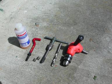

Finally the tools I needed. The inserts in the kit were too long I found that wire cutters were able to easily cut them down to the right length without deforming the coil. In order to drill out the old thread I had to purchase a 90 degree attachment (on the right of the photo. It worked well but you find you need three hands to keep it steady.
