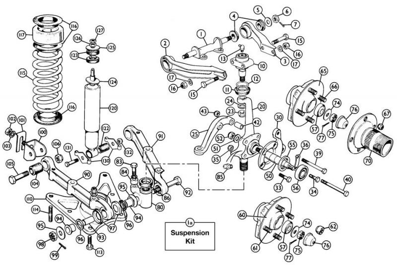

I have some notes on this which may or may not help

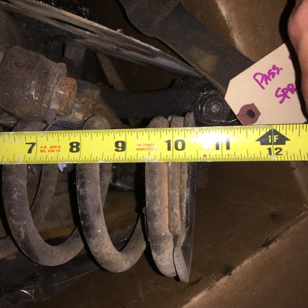

Stock TR4A came with long springs (10 ¼” unfitted).
Stock TR4 came with short springs (9 ½” unfitted).
Aluminum spacer/Packing piece came thick or thin accordingly. I appear to have a 1" packing piece but don't know what that means.
Stock spring rate is 312 lb/in
My car is a 1966 TR4A and I believe the suspension is completely stock original. With 15" wire wheels and 165/80-15 tires at 35psi, ride height from ground to lip of front fender is 28 1/4". Visually, I think it looks high. Someday I would like to pull my front springs and measure the unfitted length
