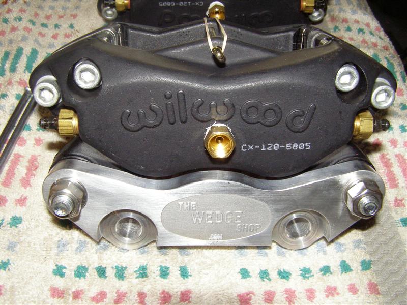

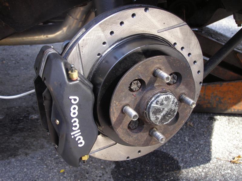

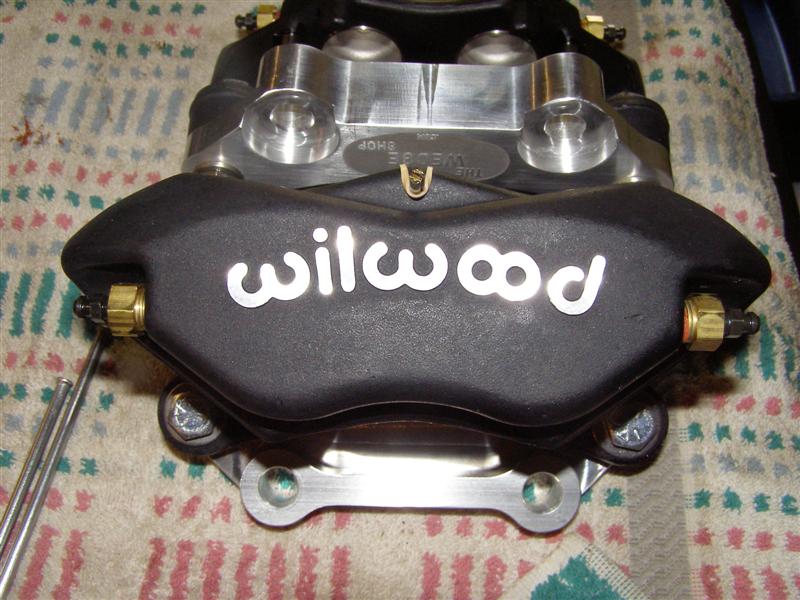

I recently removed the Rimmer Big Brake kit from my TR8 and replaced it with a Wilwood kit from the Wedge shop. I did it to allow me to not use spacers on the front, other than it was fine. But in doing so, I found the the new Wilwood caliper weighed 3.8 lbs and the Wilwood rotor was 10 lbs. The Rimmer caliper weighs 14.o lbs and the rotor also weighs 14.0 lbs. 28 lbs per side versus 13.8, so that's double the weight.

How'd you like bleeding the brakes with those 2 nipples per side
Don,
I sat in the car and pumped the brakes. Woody did the bleeding, but it was rather quick, considering the amount of bleeders and going over each side three times. But with the new uprated booster with the bigger bore master cylinder, there is no pedal drop and it stops on a dime. It did with the Rimmer kit as well, but no wheel spacers needed on these.
And it's four nipples per side. Two front and two rear on each side.
