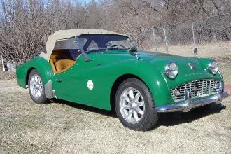

There's nothing wrong with minilites!

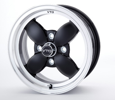

Richard, the VTO wheel fitment we use for the big Triumph is +3mm, 3.58" of backspacing. There on a free shipping deal in the US 48 this month with free Triumph center cap logos, lug nuts and valve stems. I have that fitment in the VTO Classic 8 in sliver or black and the Retro 4 in silver or black. Give me a shout if I can help.

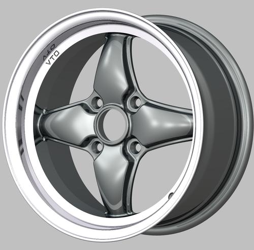

Also worth mentioning to you big Triumph guys, we're also making a new remake of American racing Lemans, it will be known as the VTO Lemans. I saw the prototype earlier this year and it was in a new color, it's darker than silver, but lighter than a charcoal greay, I really liked it, this may or may not become the production color, I put my vote in for liking it, so we'll see, it much richer in depth than a normal silver. We made this wheel from a suggestion from Peter Brock, he will be selling them to his Datsun customers, but we made them in size and offsets for MGs and Triumphs as well, it will beffered in 15x and 15x7. I've been told alot of Triumph guys are fans of the Lemans wheel, so maybe this interest some of you. They should be ready for sale by late summer/early fall.
