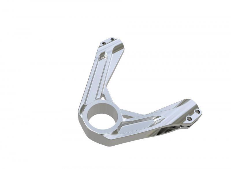

Upper control arms.
CAD.
Render.
Print

Wow, really nice work.
I hate seeing hacks, workarounds and kluge ways of doing things you so often see. I love seeing what you are doing. You obviously have some great resources.
Wow, you 3D printed it to verify before machining it from aluminum. This is a serious build.
What was the 3D print time versus the machining time?
Usually that is what we would do, but my printer was slightly too small and I had to scale it down by 5%. So it was just for fun. Print time was 13 hours. Actual machine run time on each arm was 7 hours. Also a lot of hours into making custom jaws and setup.
