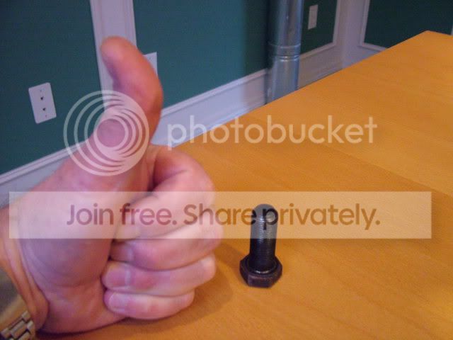

Glad you resolved that one!
err.... rather 'unscrew that'.
hmmm... I wonder'd where my Seiko watch went.... :smirk:
DNK said:
As Tim "The Tool Man" Taylor Says
<span style="font-size: 26pt"> MORE POWER!!!!</span>
That is one whoppin big thumb, should have no problem catching a ride with that baby..........

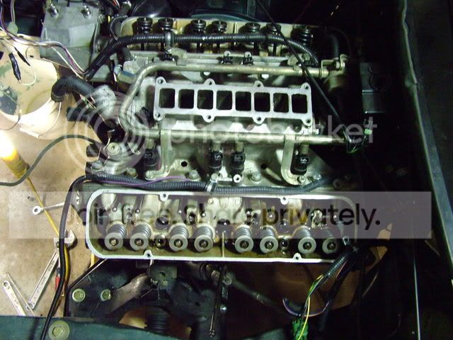

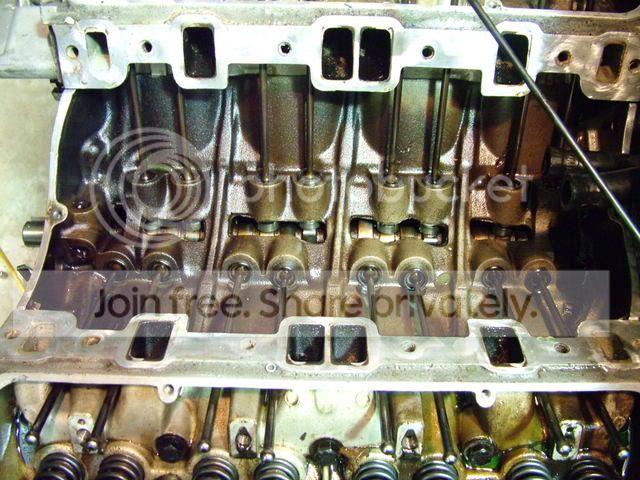

You tell me . Looks like a V8 valley to me and I have never seen one.
Tom- Piece of cake to do. Really easy if you have an unsmoged 4 barrel.
Little tougher with the fuely motor
There is coolant everywhere and my garage reeks of gasoline.
