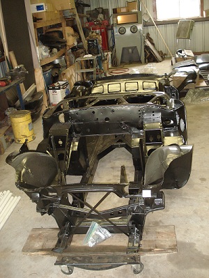

Best way is to completely dip the frame to coat inside everything. We has our chasis acid dipped to remove any rust, then we repaired the rust and then dipped again followed by a thorough rinse. The final dip is called E-coating. It is like a powder coating only it is dipped in a liquid solution. ALL new auto manufacturers use this process on their new bodies and it is very good at preventing rust. On our car with much less use than originally intended, it should last another 50 years before it even starts to show any rust.
VERY commendable Jim, bravo! There's a former Redi-Strip place in Toledo (American Parts Cleaning is what I think they're called now) and they do the "alkaline immersion" process, and the metal comes out spotlessly clean.
While they did not offer an E-coat process in house, they claimed there was a place around Detroit that a lot of people took their dipped cars to.
I had wondered how they did it on cars post manufacture, so thanks for clearing that up!
