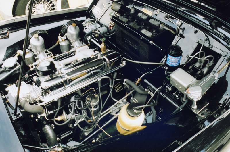

Agree. That's the cylinder that I am using for the clutch on my 4A (with the HVDA kit). But the reservoir is smaller than a 4A master and the cap is plastic. Girling cap won't fit on it. I used to use Wilwood calipers on my race car an is good quality.
I'm using a TR6 setup with booster for brakes on the 4A.
