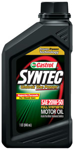

Ken and you Castrol fans. This will be going in mine on the spring oil change. Made especially for flat tappets, plenty of ZDDP:

The only problem I have with the Castrol Syntec is it is a synthetic. I don't need anything that is going to leak even faster.

Not all synthetics do that. As a long time user of Valvoline synthetic, I can report that not one of my cars (including non-LBCs) has leaked any worse; and in one case oil consumption actually dropped remarkably.
OTOH it was Castrol that argued that the word "synthetic" is basically meaningless ... I wouldn't pay extra for it.
https://www.google.com/#hl=en&q=castrol+hydrocracked+oil
