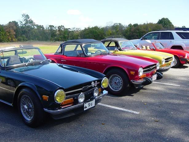

Here's a mix & Match of Hella Rallye's 100w grass burners & my orig Cibie 95's on my '88 Range Rover that were orig. on my dad's '71 Ford f150 PU till it rusted away, still shining bright almost 30yrs later. If you buy the high end Hella's the quality is very good, the Rallyes were alum housing with knurled nut adjustments. I bought a generic high beam foot switch that I ran them off through a nice heck harness & Relay.
p.s my bride surprised me with the Hellas as a Bday present! /ubbthreads/images/graemlins/smile.gif
https://s121.photobucket.com/albums/o219/...mgAnch=imgAnch2

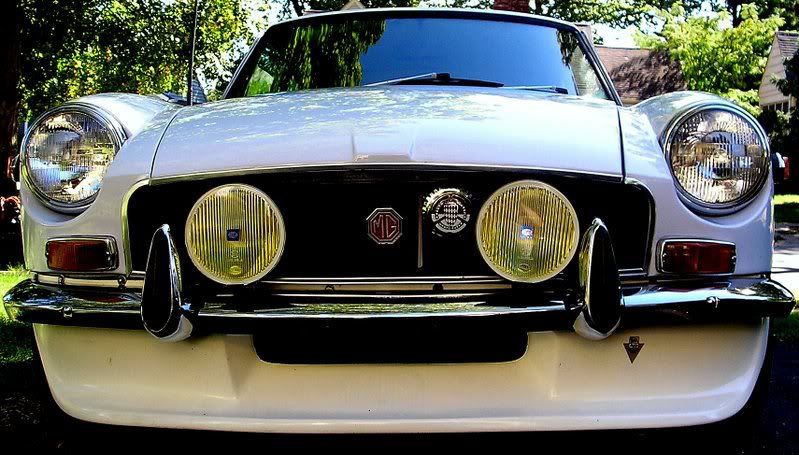

Sorry to intrude, but here is my set up. I used the Hella 500's in amber. Other makes look better with chrome surrounds but they are a good deal more expensive. I have a relay and independent, period correct switch gear on the console under the stereo using an old MG fan rocker switch in the spot where the rear defpogger switch would be (GT). I use them often because I like the light and it will cast a very wide beam. I can see the light on the porches of the houses lining my street when I'm driving on it, and they are about 40' from the curb.
I don't think using both light types at once in the clear dark is counterproductive, you just have an overlap. I wouldn't use both in heavy fog but that is so rare here.
Why did I get them, then you ask? Because I think it looks cool, really.
