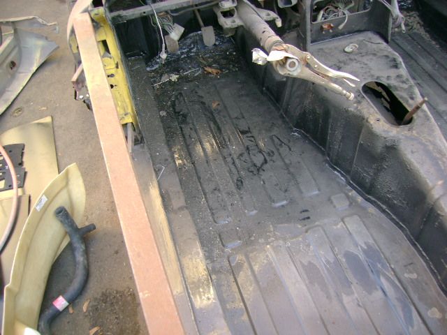

This is the last one we did. Cut at the inside of the 1" lip around the edges and it has a lot of rigidity.

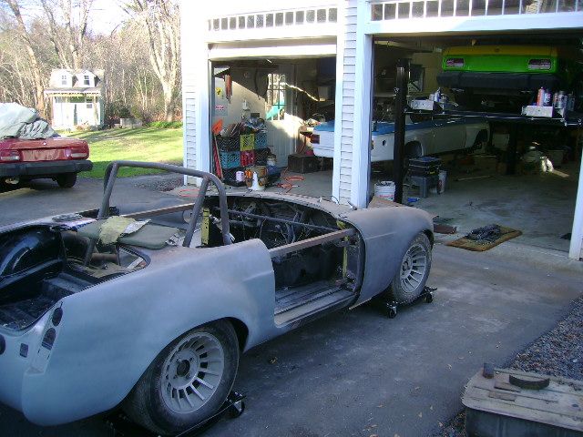

Cross braces should be installed like this to prevent the car folding in half when you cut out the floors and rockers.

Then just cut away and fit the new panels. You may have to make up some intermediate pieces where gaps between the new and old metal meet up. Not very hard, just time consuming. I have found that once you tear into the floors, it doesn't matter if they were just a little bad or very bad, it's the same amount of work to fix them the right way. These were overlapped and seem welded on both overlapped edges.
