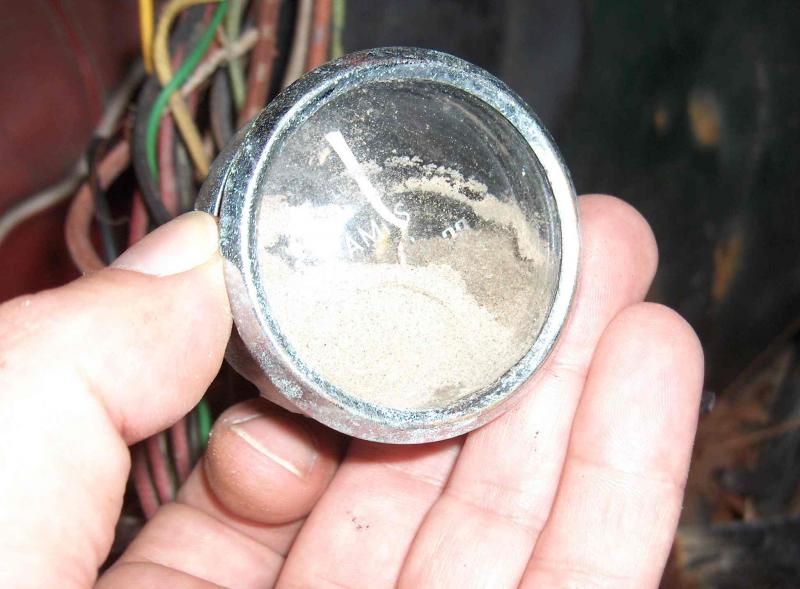

I am down to installing the new interior and sorting through some electrical gremlins. I need to remove and clean the gauges. Any suggestions on best way to clean the face of the gauges? There is a waterline and fine silt on them.

I had a water line on the only gauge that didn't implode from the water pressure. Within a year or two of the salt water addition, all the "electronics" (including wire) were not useable because of corrosion. I found suitable replacements and keep the ammeter for show-n-tell. You can open them up and clean them but be careful of too strong a cleaner or you will wipe the white lettering completely off the face. I used a q-tip and mild soap on the face and needles and glass cleaner on the lens (of the replacements). If I were you, I'd clean the mechanical portions as well being sure to lubricate anything that moves in any way. This stuff is rugged and will take some abuse, but water takes a special toll.
