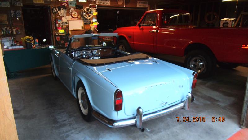

DSCF5852.jpgCould someone please tell me where the flasher on a 1964 TR4 is located?...Marla

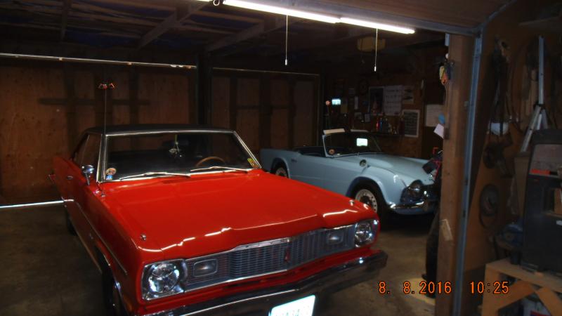

DSCF5894.jpg....So I got a new flasher and put it in last night and am happy to say that the turn signals now function as they should...very relieved about that...Marla
