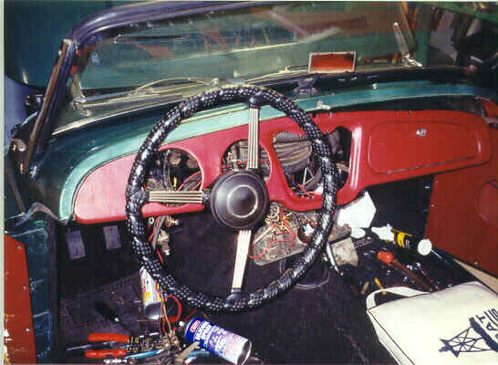

Behind that amber lens is a little screw in bulb which you have to gain access too by reaching your hand underneath and behind the dash where that bulb is located. The bulb is in a flat paneled socket with a wire coming out the back and is basically installed with two metal prongs holding it in the hole by friction. If you grab hold of the recepticle (not the wires) you should be able to remove the entire recepticle and bulb usually by lifting out one side first. Now the fun part, the wires may not allow you to fully remove the recepticle to a point where you can see what your doing. You have to do most of this by feel. Unscrew the bulb and check to see if it is blown or not. If not you can clean up the contact areas to both the bulb and the socket and try it again. My bet is the bulb is blown. After you replace the bulb you have to plug it back in in order to gain ground for power. Assume it's positive ground? Also by reaching your hand in there be carefull because when I did this I must have jostled the other bulb wires and it was like stringing Christmas Tree lights. One would work another would not. Wound up replacing them all and cleaning the works. If you want to git her done NAPA sells the bulb just make sure you bring the old one with you. make sure the key is off and signals are off and don't try to plug anything in or out while it is on this usually shorts the bulb. Or you can get carried away like I did in the attachment and really tempt the Lucas God to make your day!
