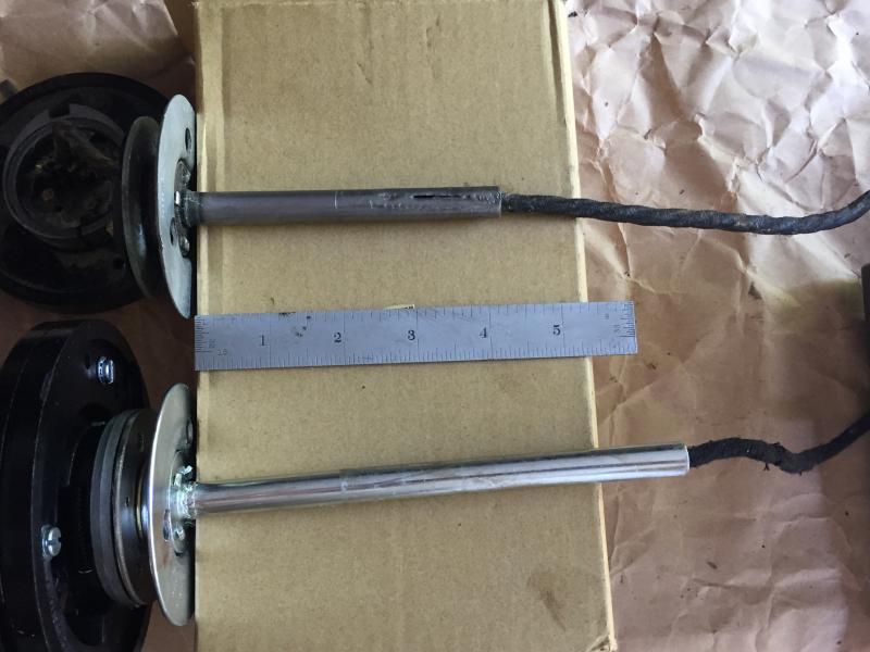

I rummaged around and found the control head I had taken out when I dismantled one of the two cars I used to build this one. Here is a photo:
As you can see the new control head tube is nearly 2.5 inches longer than the old one. Although I couldn't clearly see down the steering column far enough, apparently the bore is narrower starting about 5.5 inches where the control head seats in the steering wheel. Nothing larger than the stator tube would pass that point and whatever the obstruction it wasn't moving. The tube on my new control head was 6.5 inches long. My solution was to cut off 1.375 inches from the new control head tube. To protect the cable I made a ferrule from a piece of sheet metal and slid it up the control head tube above where I was cutting. I also used a hacksaw instead of a cutting wheel so I could be cautious. The tube is pretty soft steel, so not difficult to cut.
Result: All fits and there is a little more than an inch of the stator tube extending below the olive nut. The tough part was it was more difficult to thread the cable down the tube after I had pulls it in and out several times while working through this.

Thanks Steve,
If you enlarge the photo you will see that the bakelite base is in shambles. The cable was not in good condition either.
The car I am restoring [almost complete!] is the combination of two cars. Nearly all the mechanicals are from a rust bucket I bought for a few hundred dollars several years ago. The frame and bodywork are the remnants of another restorer's parts car that I got for free. The investment to get where I am was substantial, but it's been a fun challenge. Re. the control head, the grub screws were so corroded I couldn't get them loose, so I had to pry out the control head. After I got the steering wheel off the column I was able to drill them out and re-tap two of the three.

Well, you found a way to make it work...However!!...The picture you show is for a non-adjustable control head on the top, and an adjustable control head on the bottom. I think your PO (not the assembly line) has mixed the parts in your column. I.e., you are fitting an adjustable wheel on a column which is all or part for a non-adjustable column. At some point you will adjust the column longer and the stator tubes will part ways.
As a note...I have easily swapped the long stator on the control head for a short stator. With a little fiddling the tube unscrews, so you do not have to cut or otherwise modify the tubes to change the use of the control head. And sorry...I should have been following this thread, but I didn't until now?!?

I appreciate your comments, but I respectfully disagree. It's possible the old control head I have is not for an adjustable column, since no one knows what a PO has done. I do have a new fixed wheel control head I purchased but haven't installed in a 1960 TR3A I also own. It's tube is only about 2 inches long.
I looked at swapping the tubes between the old control head and the new adjustable one, but the new control head is attached with rivets so not easily done
In any case, the total range of motion on whatever column I have with my adjustable wheel is a bit less than an inch, so there are no risks of the tubes parting. The column is one piece, and since the adjustable columns have a different size end spline than the non-adjustable I don't think it was switched out. I wonder if older cars [I note yours is 1955 while mine is 1958] may have had different adjustable columns than I have. There are parts I have seen in the Moss catalog that I don't have, e.g., the chromed shroud and Randall commented that the overlap of the tubes is much longer than I have [or need]. I suppose another alternative may be the PO may have put an adjustable shaft in an non-adjustable steering column.
