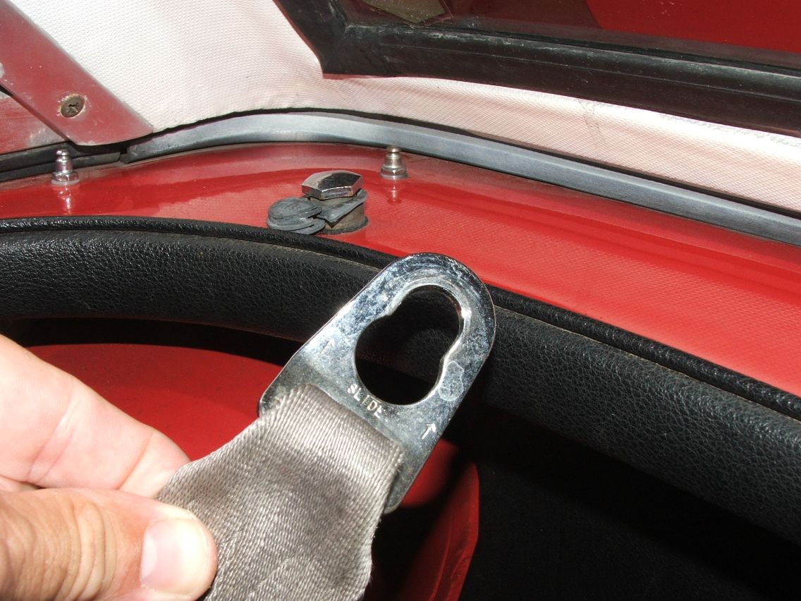

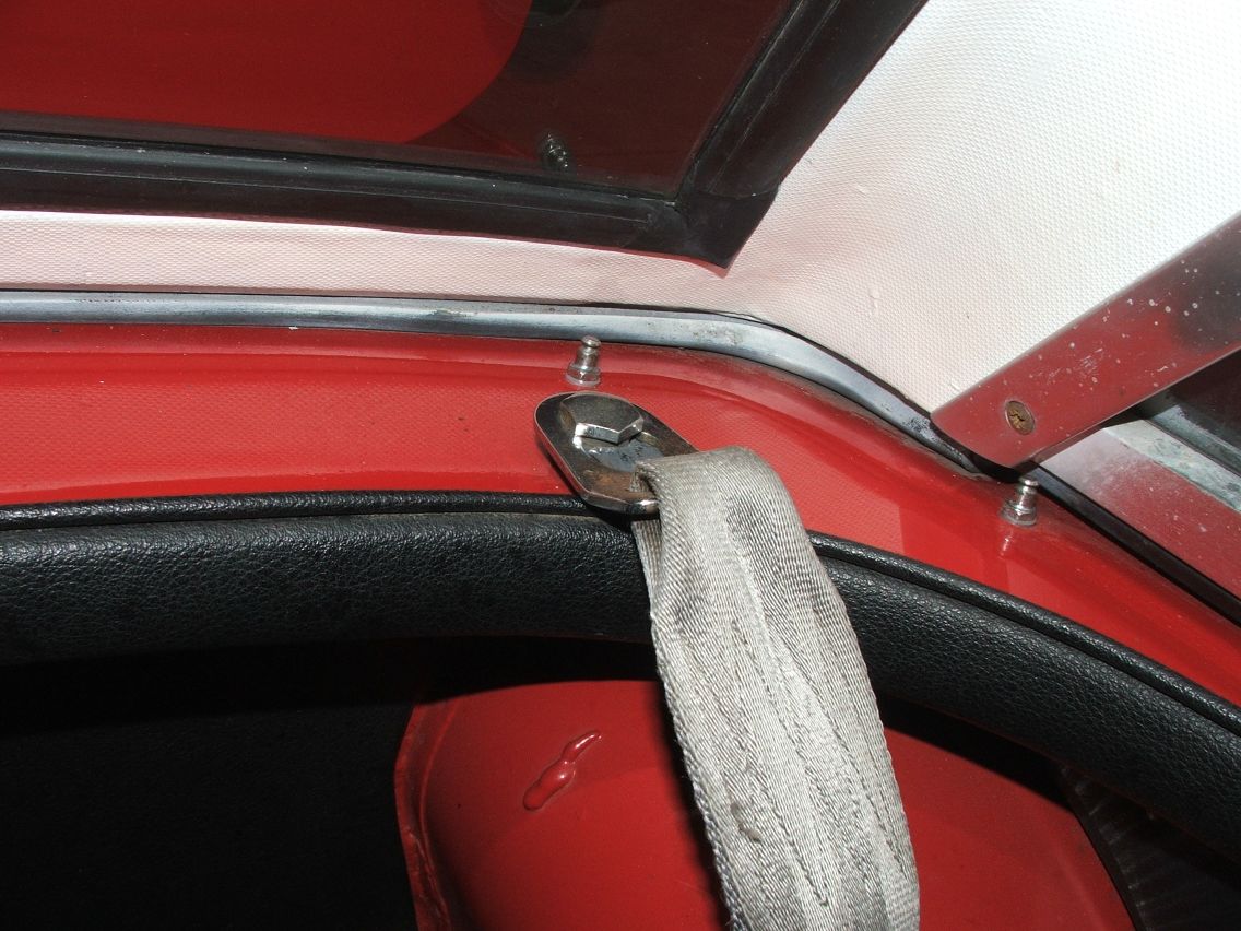

Rick, any chance you could send me a pic of the "hook" that clips to the deck lid stud? I'm going to dig through a trunk of belts, and it always seems to help if I know what I'm looking for. Keith kjkuzma@knology.net
Re: First stupid question. rear deck hardware 71 m
Here you go!
