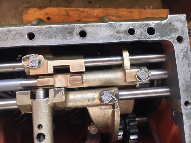

I'd say there's something wrong in the 1st/2nd shift fork, but you'd expect that to affect both gears. The only thing I can think of is the set pin that secures the fork may be loose--if so, he has a potential major problem--but, again, I would expect that to affect shifting into second as well. If he has a centershift box (you didn't specify), it would be worth pulling the top cover for a look.
I've seen instances where people didn't properly safety wire the set pin--just making a loop through the pin--that, at best, would only keep the pin from falling into the gears if it worked loose. Safety wiring has specific requirements in order to be effective, I tried to follow those rules (and I used threadlock suspenders to go with the belt):

Bob_Spidell
You can see the spring-loaded reverse lockout plunger at the bottom left of the picture I posted (depending on how your browser orients the photo). There isn't an adjustment, per se, but I suppose you could shim the spring.
