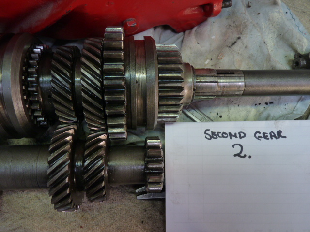

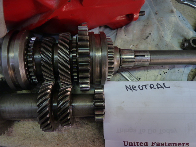

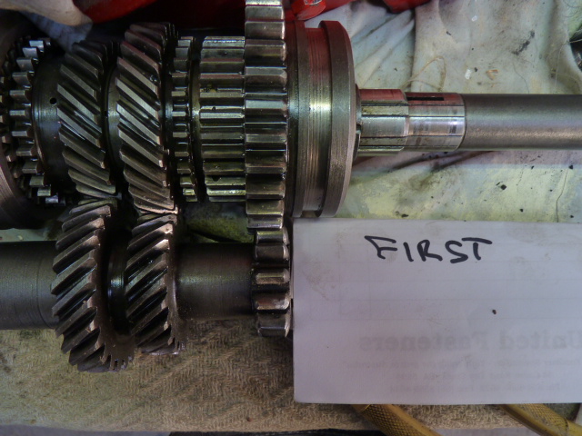

My sons name is Paul so you must be a good bloke. The first gear is not going far enough to the right for full engagement i dont have another gearbox to compare the fork position with.( I have contacted a guy who says he has an mg y box and hope then to compare with) I will post pictures of first gear, neutral ,then in 2nd Saltiga

Paul I have just looked at the pictures and in the first gear position its possible to see where the gears have been meshing there is a darker area to the left on the first gears at the mesh point Saltiga

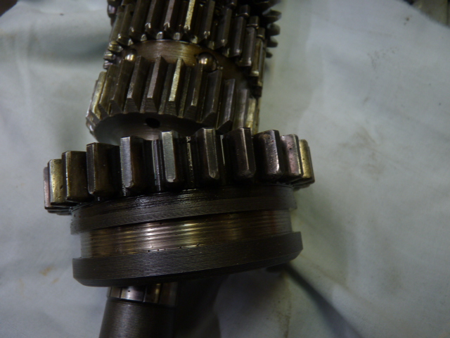

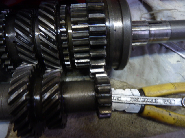

The 1st /2nd gear fork is made of steel, mine has a .010 clearance.and can be built up with weld. the first gear is held in by the fork and the ball and spring on the shifter shaft, the fitting of another spring , ball and another indent into the 1st/2nd gear shifter shaft will also help. the position of this is in the machining hole for the interlock balls between 3/4 and 1/2 shafts. I have a suspicion that the out of alignment of the first gear will tend to wear the teeth on first gear into taper as evident on this gearbox it also wears the first/second slider as evident in the slider gear spline. now if this is the case then jumping out of first gear will be more of a possibility. the gear wearing in the center will tend to leave a shoulder of unworn gear helping it to stay in gear this of course is supposition. A close look at the first gear teeth shows this taper the best I can measure its about .020inch, the wear on the slider shows the first gear has been a sort of rocking motion also adding to first gear jumping out of mesh

Okay, seeing those pix it appears the incomplete engagement has tapered the teeth of the first gear, I'll assume the laygear exhibits the same? That doubles the angled load as result. That would effectively induce a sort of side-load on the gear, inducing the "rocking motion" you describe. Wear on the shaft splines worsens, the ramp effect increases and the result is popping out of first gear on load.

Yes, the lay-gear is also tapered, its hard to measure but i have about .005inch taper wear on most of the teeth. My thoughts are, if this is common with td/tf gearboxes its why many complain of first gear problems i have the MG Y box now but the first gear and lay-gear are missing. Can any one give me the measurement of the neutral to first gear selector shaft indents, mine measure .670inch This is also hard to measure accurately but its in the ball park. I will be replacing lay-gear, first and slider. Has any one used the rebuild lay-gear?? Saltiga
