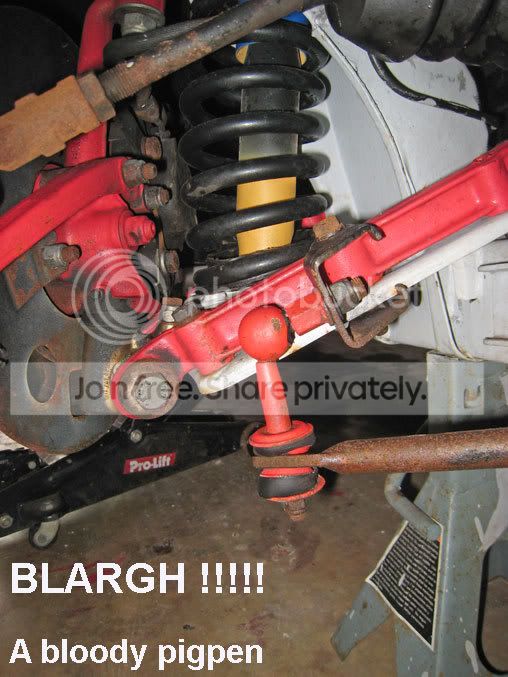

My son mentioned that we had painted one of these things with KBS but that it did not stick well and CCURTISS recommended using POR15. I'll admit that I haven't tried POR15 but when I was looking for paint to use on the parts that attach to the frame I looked at both POR15 and KBS. Both are sold via the web and not distributed through normal paint channel like Lowes or hardware stores. I suspect that both are made from the same basic stuff but have not verified this. I believe that the KBS did not stick to the bronze because it was not a rusted or blasted surface, but was smooth a shiny.
I can say that when KBS is applied to blasted parts that it sticks like crazy and forms a coating that seems to be impervious to dents or bangs. I took a finished suspension part and banged it against the edge of our workbench - not a scratch or dent on it, so I'm hoping it will hold up to rocks and other pavement hazards.
I love the way the KBS goes on. I put two coats on all our parts but suspect that I could have gotten away with just one. A quart has covered every suspension part on the car along with the rear leaf springs and the diff and we still have some left over. It would make an low-cost alternative to powder coating for a frame. The appearance when dry is glossy black.
