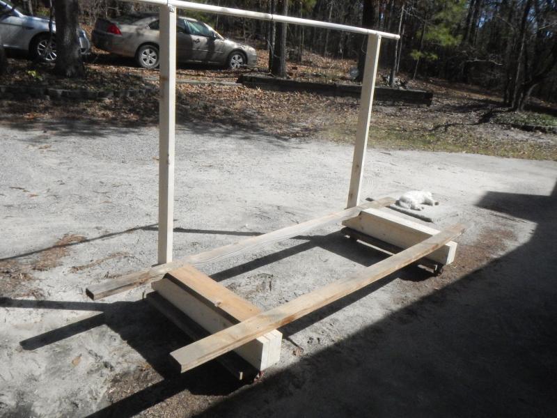

When I built my buggy I made sure the pieces that connected the ends were high enough that my engine hoist legs would fit under them.
The buggy was used for body support during body work and to move the body around. Later I modified it to be a sand blast area for wings and other parts. It held some blue tarps so I could contain the media and reuse it. The PVC pipe was to hold pieces that had been painted
Later it became a painting stand.
This photo is its first version before I raised it to clear the hoist legs.
David
That is my helper sleeping on the job.
