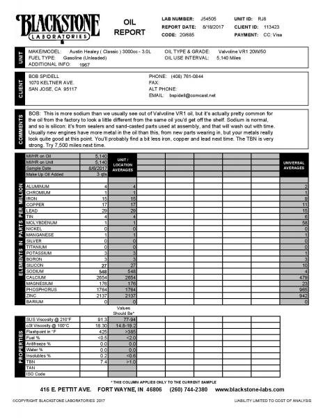

I've never done oil analysis before, but out of curiosity I had one done after my BJ8's overhaul. This is for over 5,200 miles of running; 3qts VR1 and 2pts of GM EOS added (ran break-in oil for 250m before switching to VR1):
