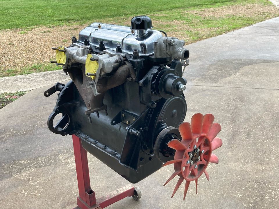

After all these years final treat my TR3 to a Macy fan and Wizard aluminum radiator..
I have been using the wizard radiator in my TR4s for 10+ years. I also have the wizard radiator and Macy fan in my 2 year old TR3A restoration. Way to go!!!
Charley
The original factory radiator was ONLY hampered by air flow problems. The wimpy
factory fan only worked in cool climates. Up grading to the Tr7 fan cured all issues.
Mad dog

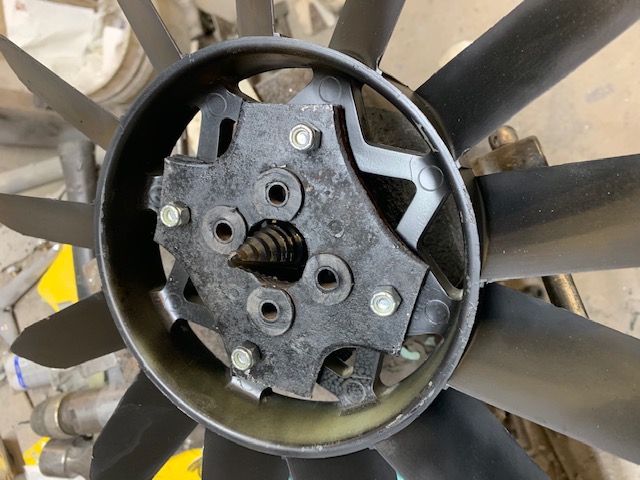

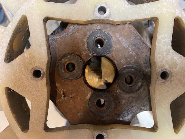

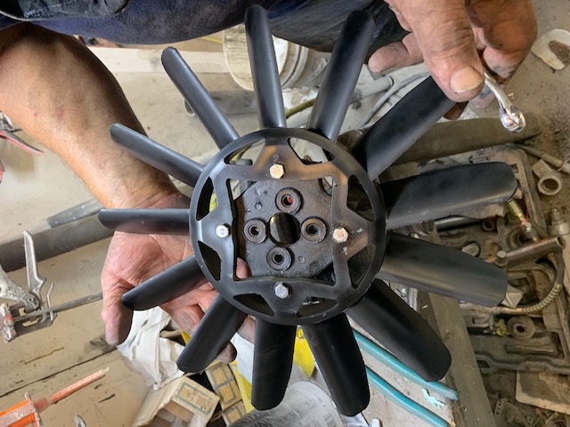

Just got back from a 50 mile road test mostly around town. Never seen the temps this low except during the winter.
The Tr6 fan can be made to work also but it is a lot more trouble. Involves some welding.
Mad dog
