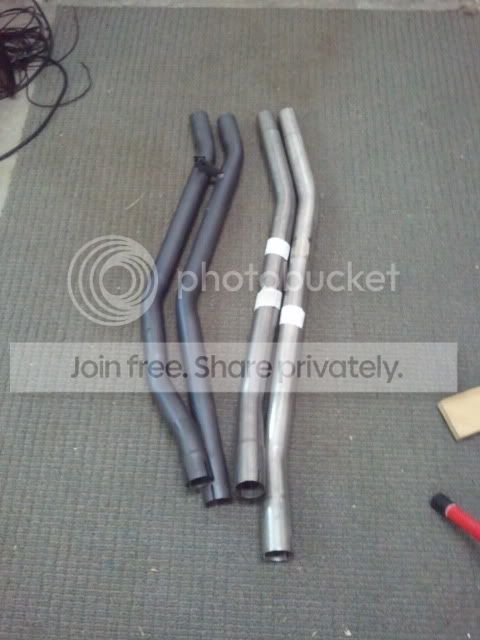

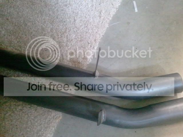

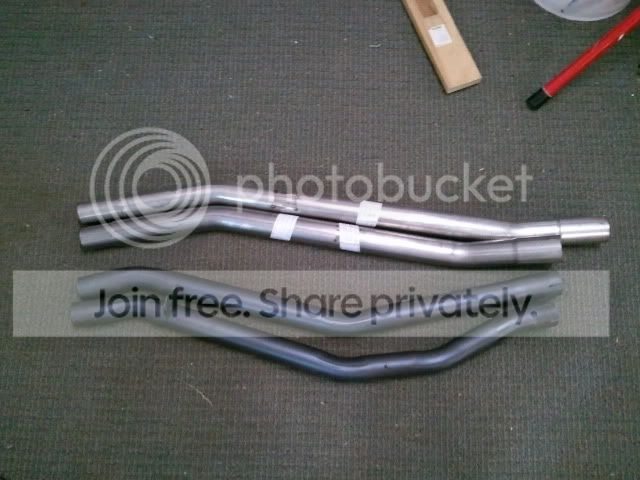

The TT headers are built that way.
Here they are on my garage floor for a photo shoot to send to Moss.

If those are O2 sensors in the down pipes,They also put the bungs for the O2 sensors in an incorrect position, it should go down in the collector pipes where it can measure ALL cylinders, where they are now its only measuring 2 cylinders, providing you have 2 O2 sensors
if you are putting O2 meters in I would relocate the bungs and plug the existing ones
Hondo
Maybe not monotiring all 6 cylinders, but at least capable of representing what the 2 carbs or TBI's are doing.

Keith , no room at the 12:00 position on those headers.
