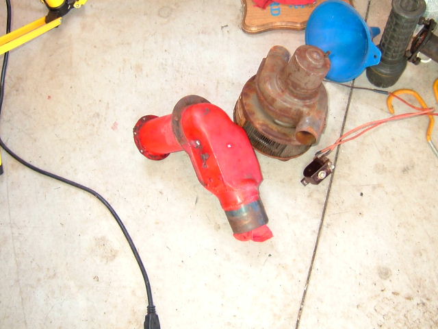

As I'm taking my car apart, I know that it has the optional heater installed with all the associated plumbing, etc. What is puzzling me are the other gadgets in this car that all have heater hose connections. One of them is a blower motor assisted heater, complete witha small core, that was hooked up to the defroster outlets. It has an intake under the bonnet, and the heater assembly hangs down above the passenger footwell. Attached is a picture, can anyone tell me where this was installed? It looks like some sort of kit that was made for the car, but it doesn't show anything about it in the service manual.

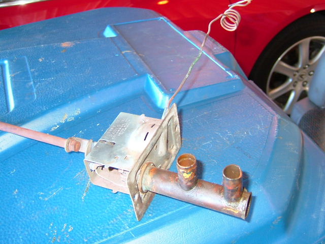

I also have another gadget that has 2 heater hose connections and mounts above the transmission tunnel. It has a lever actuated valve that sends water to the other heater, or you can shut it off. It also has some sort of thermocouple tube that mounts under the drivers side footwell area, so it's some sort of thermostatic contol. The picture of this is attached also. It was made in Columbus, OH, so I'm sure it wasn't a factory installed option! It also looks like someone cut out the firewall (messy job) to install this item. Any help on there two gadgets wouyld be greatly appreciated.

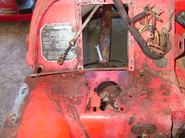

Here is the picture of the mounting for that piece under the bonnet.....

Here is a picture of the thermocouple controlled piece....

Never seen anything like that. It might have been a dealer-installed accessory, or more likely something an owner had installed to improve upon the less than stellar standard heater system.

There is mention of a Defroster (windscreen) part # 59844 and a heater kit Part # 551877 in Bill Piggots Triumph by Name Triumph by Nature book on page 172. There is also a picture of the 1955 Triumph accessories catalog that shows the strange looking defroster. Also on page 175 item (11.)Mentions that the defrosters was available from the factory and were manufactured by Lucus and maybe Desmo. It also gives a description of said unit.
There were a lot of items that were available that we just don't see any more, side spats, ah the fitted suitcase. There also was a sunvisor that was fitted to a hardtop, numerous bumperetts. Is this the same car that had the mirror radio if so looks like a special car.
I would try and keep any if not all of the accessories that came with the car and to restore those items as well.
