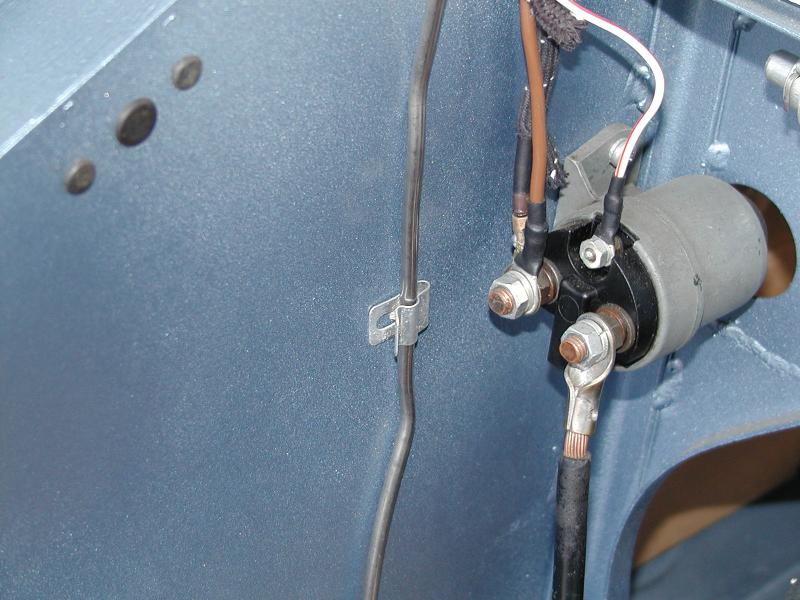

I'm in the process of re-assembling my BT7 and found an extra clip that I can't remember where it goes. It's just like the two clips that hold the water temperature capillary tube above the intake manifold. Any one know where the extra clip goes?

It's the clip that holds the steel clutch hydraulic line to structure of the car on the way to the clutch slave cylinder!

You might want to put some rubber boots on those solenoid terminals.

Thanks for the tip! I have them, they are just not yet installed. My engine is still at the shop and the battery cable as you can see is still not connected.

thanks Duane, that's what I needed to know. My car is painted the same color. I also need to add the rubber boots and also the rubber plugs in the 3 holes nest to the pipe. Rob
