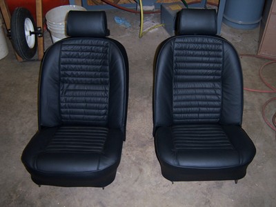

One of my winter projects was to update the seats covered in JC Whitney sheepskin covers (by the PO) and have them recovered. I used the foam kit from TRF and the leather seat covers from Moss. They didn't originally go well together. The bottoms looked good, but the backs didn't fit well. The upholstery shop had to take some material off in places to make them fit right. I've been very pleased with them so far. They have much more support than before.

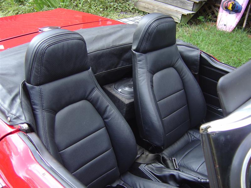

I put miata seat in too, I recovered them in leather, pretty easy job too
