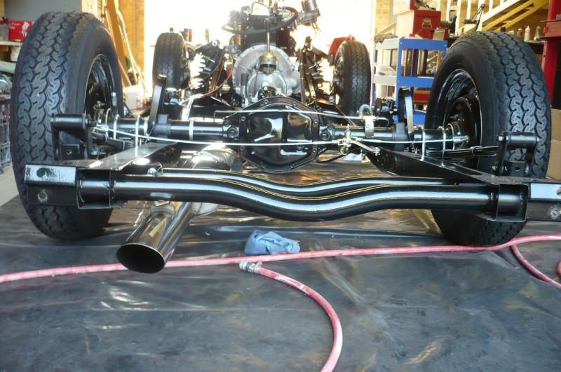

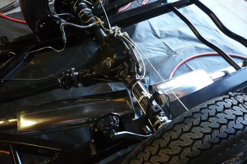

John you have owned some pretty cool cars. How could you sell the vet! Graham you know those little metal ties downs for the brake lines to the axle, where did you get them? Oh and nice job Graham!
steve
Steve
TRF part number 41674 Moss part number 14G800 can't remember which one i got them from.
Graham
