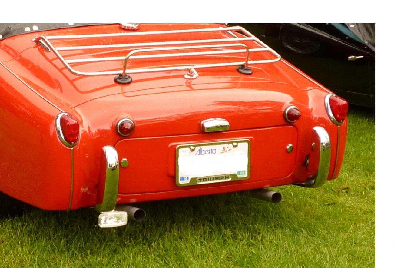

Hello Kiowa,
I have the Falcon stainless steel header, silver ceramic coated inside and out, leading to a two into one collector. From there the single pipe goes through the X box in the frame, and separates from one back to two pipes. Each side has an inline "cherry bomb" muffler. They exit the rear using the stock aluminum tips, near the overriders. The whole works is stainless. The sound is good - not too raucous, but still deep and throaty. It's not for everyone but I like the different look. It was surprisingly costly.
BTW The backup light is far enough away that it doesn't get cooked by the exhaust gases.
Steve
